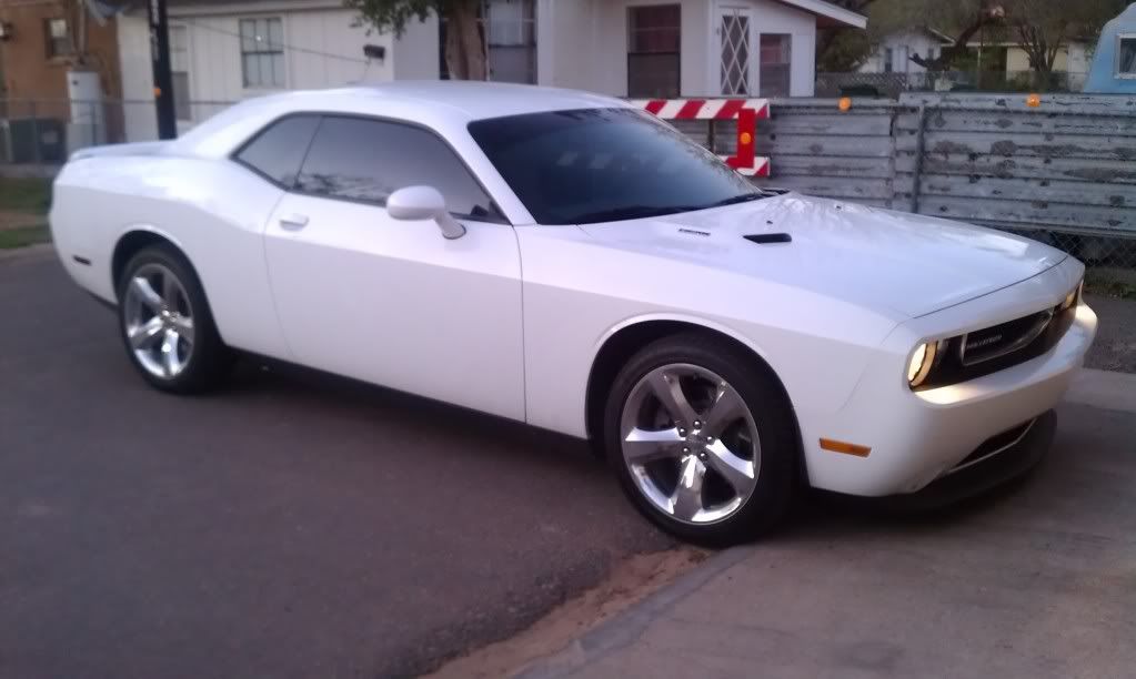

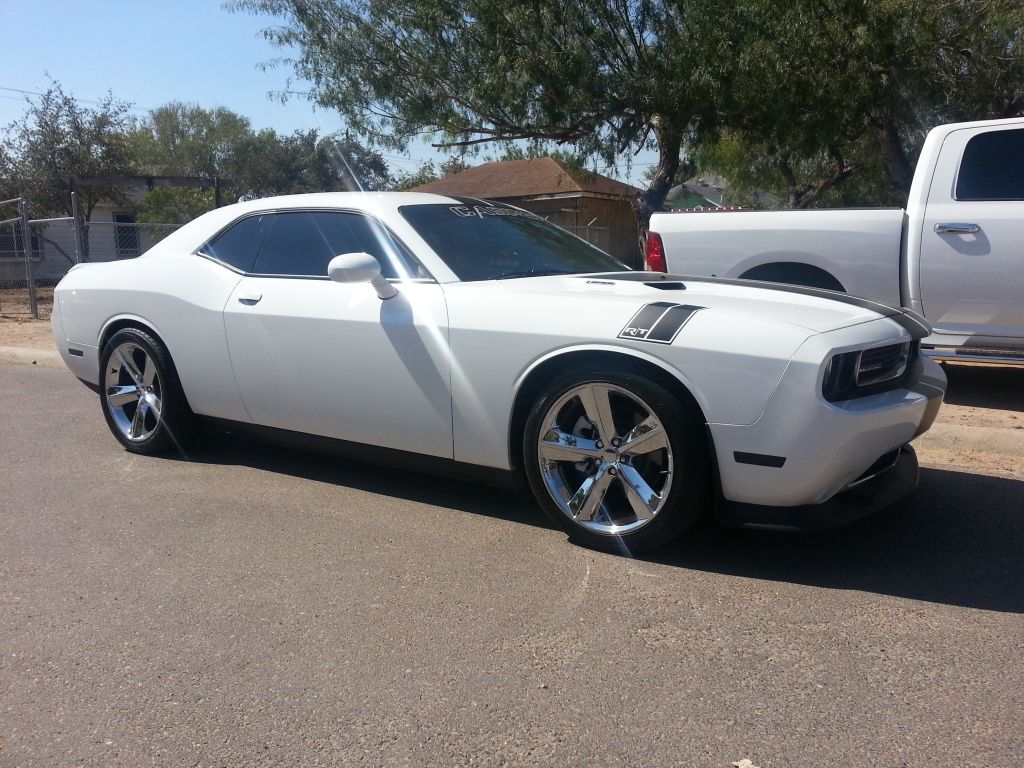

i have a 2012 rt, and I DID the eibach pro kit. just springs.
bad experience with me, once installed at the shop...they took it to get it aligned.
come to find out when i got new wheels and rims..they didnt aligned it.
had to install spc adjustable control arms in the front, and rear camber kit. i spent alot just to get aligned. sucked. around 900+
before
after
before
after
Worth every penny! Looks bad a**!!!
