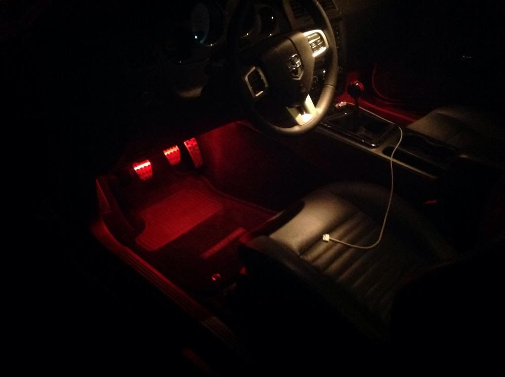

I finally installed my puddle lights , I didn't want to drill a hole in the bottom of the door so I installed them in the bottom of the door panel , then while I was at it I installed some LED lights under the dash. http://i651.photobucket.com/albums/uu236/jimr38/image-28.jpg[/IMG][/URL]. http://i651.photobucket.com/albums/uu236/jimr38/image-31.jpg[/IMG][/URL]
Sent from AutoGuide.com Free App
Damn that red looks amazing & is exactly what I want in my interior...
I've never done a mod like that myself... Any chance you could sum up a parts & install guide? Would love to try this...
That part of the mod is very simple , you just remove the pass side A -post cover and underneath there is a wire connector , just disconnect it so you can pull it out enough to work with it, then you just get some quick tap connectors and splice into the yellow/white and the green/black wires ( yellow/white ) is the positive side and the other is the ground, then run the wires down to behind the glove box ( I removed the glove box door for easy access ) plug the connector back together and pop the A -post cover back on ,run the 2 wires for both sides for the light hookup and that's about it , the A-post cover just pulls strait off it has two strait push in-style clips , if ya have any questions just ask, I'd be glad to help ,,,,
