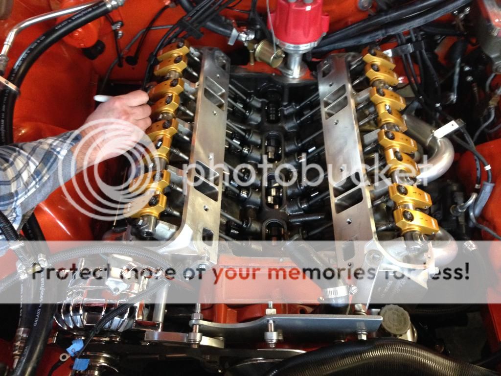

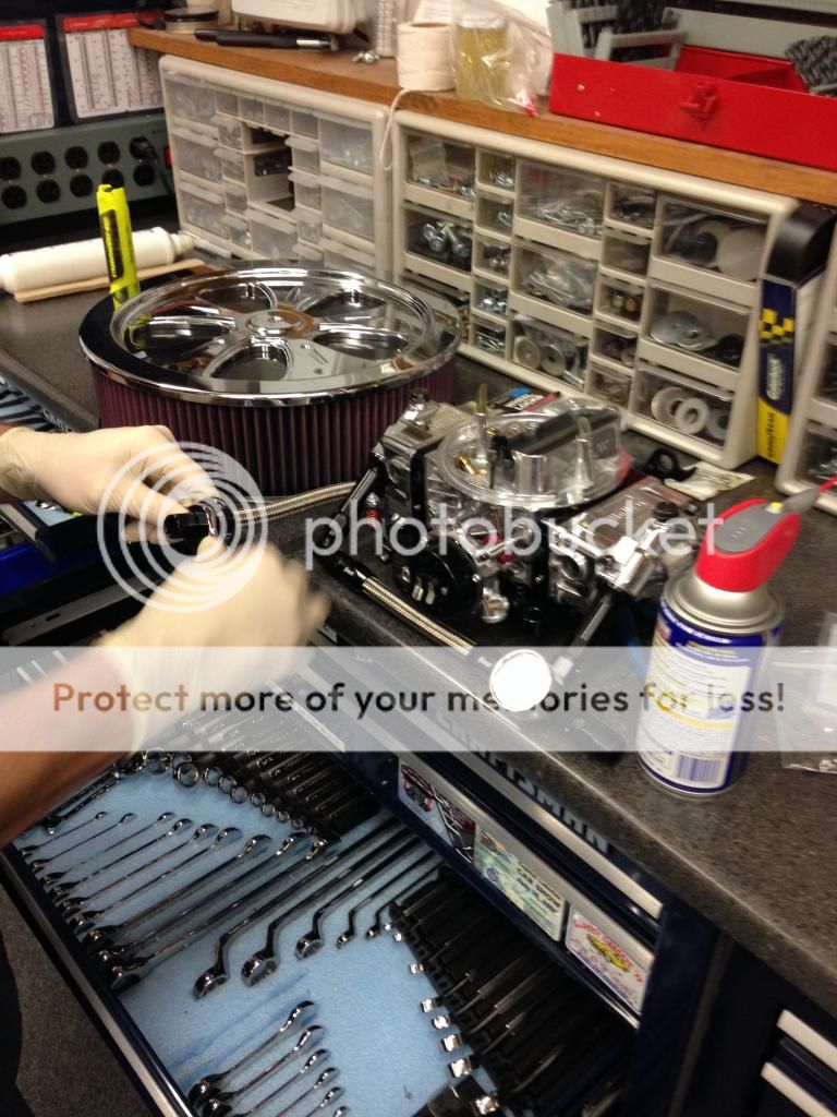

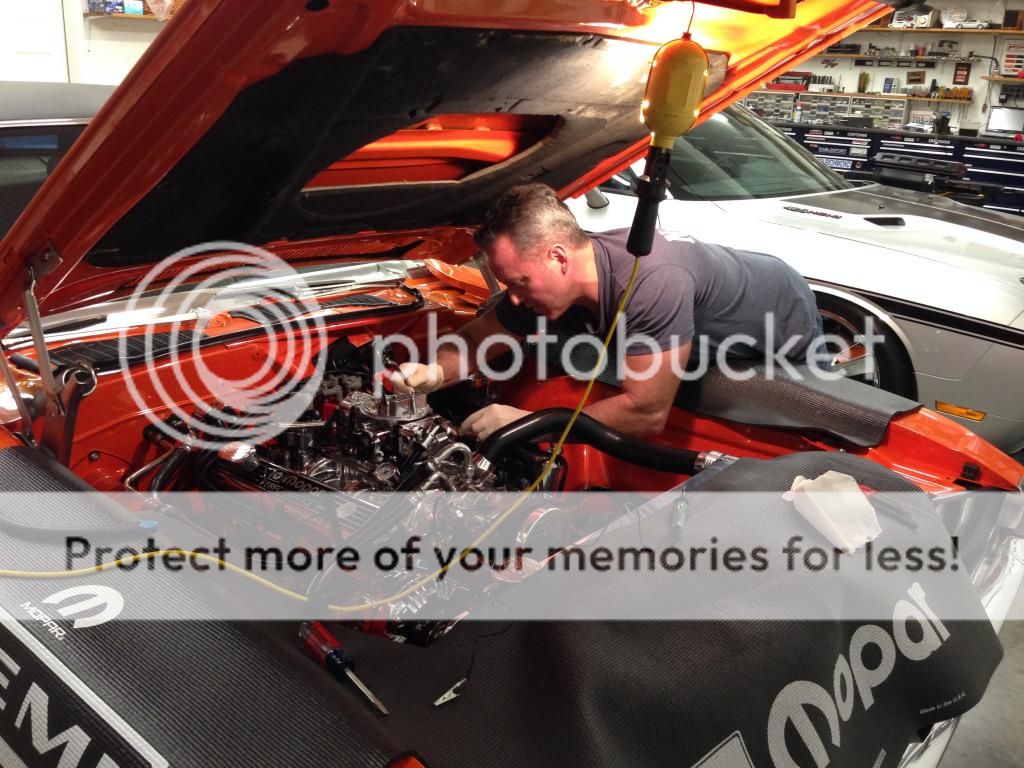

Its Time to get the 1970 as road worthy as thge 2008!! Just got some parts from Summit....Hotchkis TVS Complete with Shocks, Torsion Bars and Quick Steer and the Mopar 3/4" Spring relocation kit...Pretty Stoked!!! Finally got the top End all Buttoned back up (Thank You Mike at MRL)...With new Roller Lifters and a new Holley Delux 750 DP with electric chocke. I'll have some spare parts soon...if anyone wants them prefer Local pick up...I'm a pay it forward guy!! Right now I Have:
