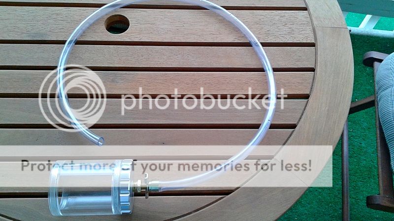

I now have 6600 miles on the R/T Classic, and have emptied the catch can twice since installation. I have now bought from Billet Technology their new clear catch can base. I will be installing this new clear base at 7000 miles and from that time forward, every 1000-1300 miles I'll check the oil level in the clear can and open the radiator drain valve that I installed in the aluminum bottom of the clear catch can. The plastic hose goes down and through the plastic shield at the base of the radiator. I'll drain it into a container when necessary.

Installed the Billet Technology clear catch can today with the drain valve installed. Routed the clear plastic tube down thru a hole already in the plastic lower radiator shield.
