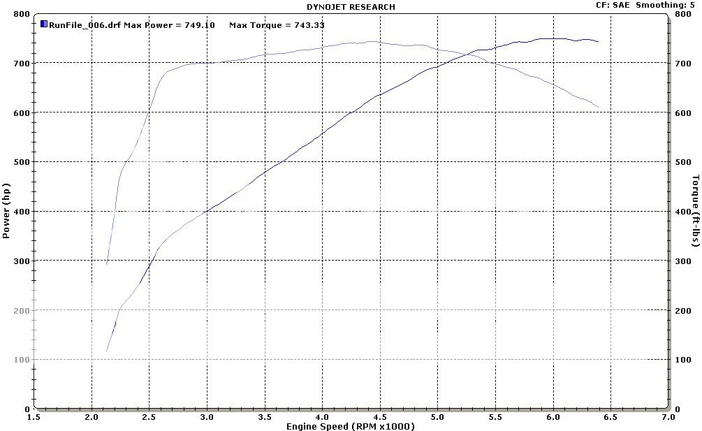

Just finished up a build for a client. Car is a 6 speed with a KB 2.8, Longtubes, and a PWR 423 CI longblock.
Car is a beast and made nice power @ 13psi and pump gas. Timing is a very safe 14* and 11.2 A/F.
I would love to push it but the client wants pump gas only so we are stopping right here.
