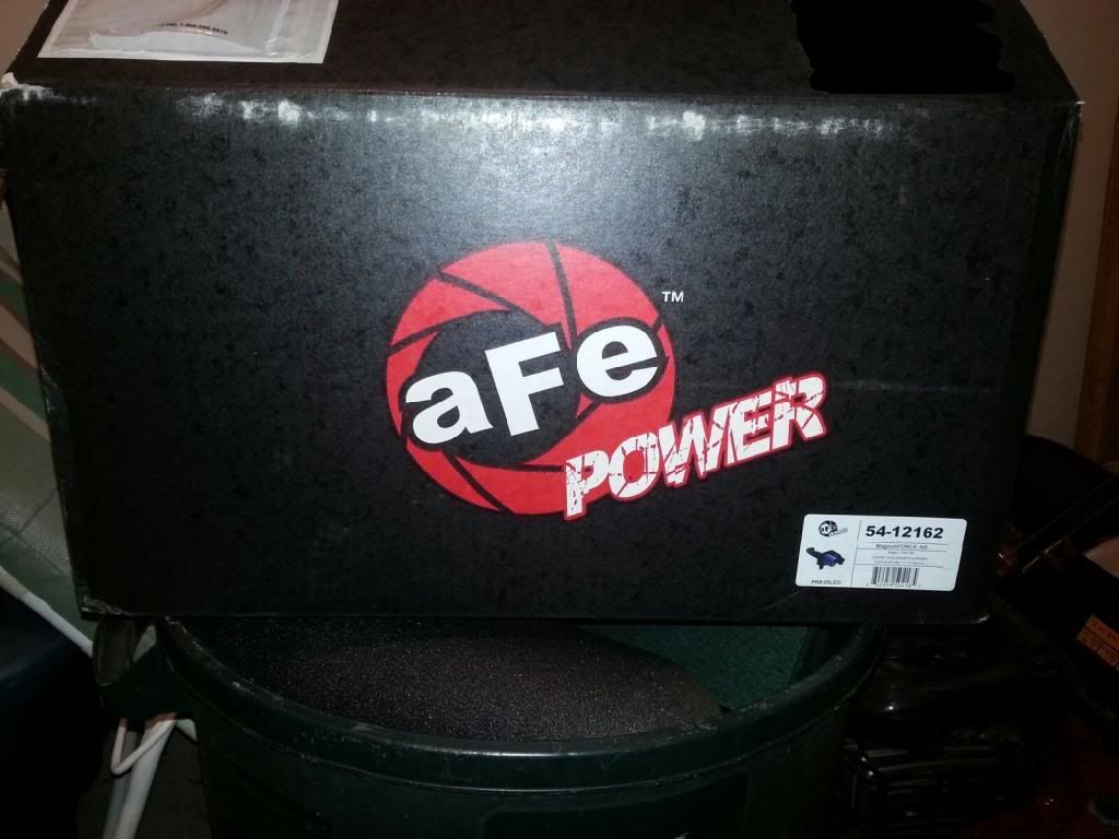

Hey guys! As promised, a right up for this intake (see here: http://www.challengertalk.com/forums/f37/new-afe-intake-96078/ )
OK! So to start, here is the box the intake came in:
