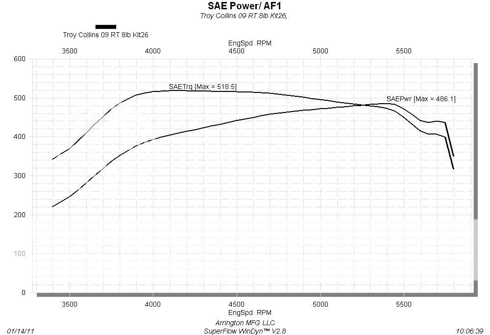

Here is an 09 R/T Auto that we did the 8lb Arrington Kit on. All Stock except for the S/C Kit. 155RWHP over stock.

Great midrange torque. I wonder why it really falls over after 5400? This is just idle curiosity, since I'm considering swapping the 6 psi pulley in my car for an 8psi pulley.

Nice numbers! What I really like is that torque curve..or torque line lol

Likely the VVT on the cam TF. Mine has a definite dip right around 5500RPMs as well. It even shows up in the TT Dyno software. It's not as pronounced as the one here, but I have a bit bigger cam which likely helped.

This one is really pronounced because that is about where she shifts. The MTCM would more than likely take care of that.
