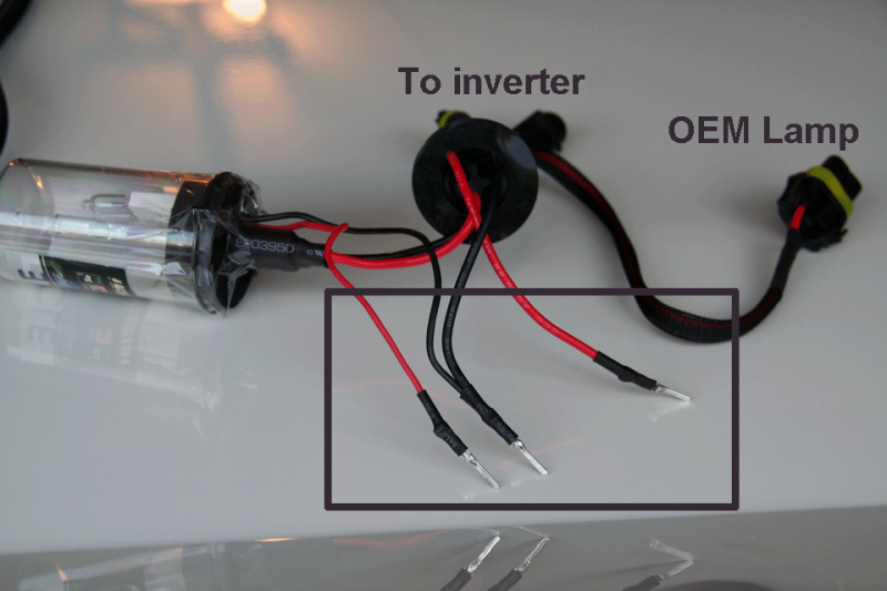

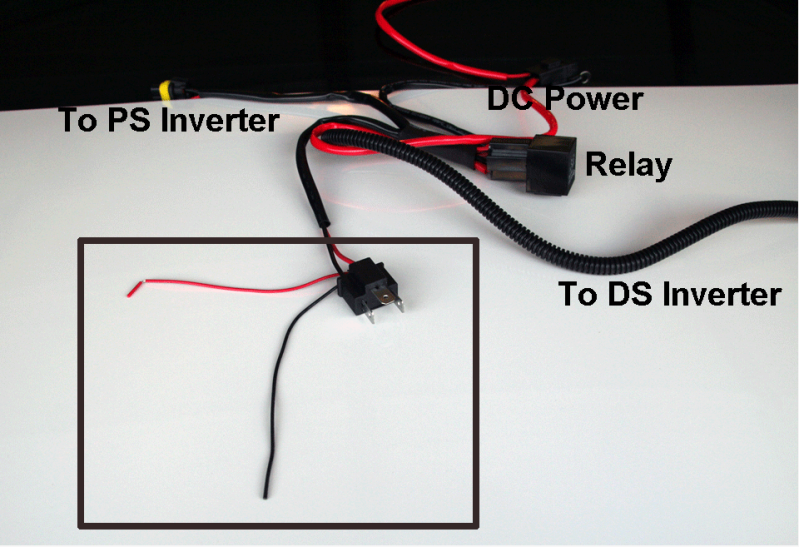

I am trying to install a set on an 09 challenger
the harness looks nothing like the picture and there are sections that make no sense to me at all
on the harness I have the parts labeled that I know how to hook up
I have no clue what to do with what is in the box
on the bulbs themselves there are wires that have molex pins on them, but there is no molex plug for them so I have no idea what to do with these either
any help ?

problem solved, cudos to AAC for tech support
