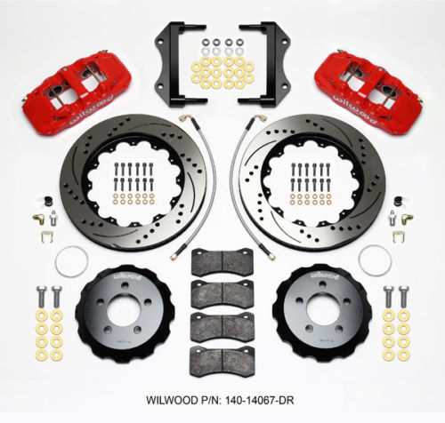

the first issue is you need everything, spindle, bracket, in some case hub bearing, hardware, pads, rotors and calipers, each spindle is over 700$ each retail, unless you have a donor car that you can take all needed components, its way too expensive to convert, cheaper to upgrade to something like this
https://www.stevewhiteparts.com/steve-white-catalog-challenger-charger-front-big-brake-kit-calipers-slotted-drilled-rotors-wildwood-140-14067-dr?parent=1053
second, the stock R/T wheels will no longer fit, not enough clearance with the Brembo calipers
also stock R/T wheels will not fit aftermarket big brake kits......

Are these 6 piston calipers?
Sent from my SM-S975L using Tapatalk
yes, same as the new ones for Bigred, only difference are mine are customized by Wilwood for all out racing, its not a off the shelf kit
and we have the ear of one of the engineers which can help us with brake pad selection for your racing a certain application

the basic parts list, not including brake hoses etc
