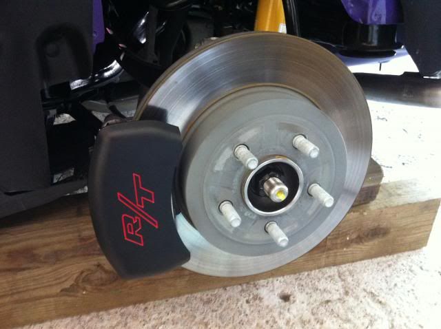

anyone install these before? I thought it would be a no brainer but nothing went like the videos I've watched on you tube. I guess at least the back ones will work, they don't completely cover the caliper brackets and no matter how you tighten them down they still slide around so I'm afraid they'll move around on their own and get hung on the wheels.
the front is a really different story. the clips when installed will rub the caliper (doesn't that move?) and according to the instructions the brackets on the covers are supposed to rest on the caliper brackets on each end.. get one on one end they other is a couple of inches short.. looks like they sent the wrong ones but then again maybe it's too simple and I'm overlooking something obvious.. any ideas or help?
thanks.

That's how mine were when I installed them, it's really not a big deal. I've had them on for over 2 years with no problems, I actually just recently took them off to wax and polish them and then reinstalled them.
And if you do over tighten, the brackets will start moving, just make sure your rotor is clear of the bracket by spinning it and everything should be good. ImageUploadedByAutoGuide1399826749.805256.jpg
And if you do over tighten, the brackets will start moving, just make sure your rotor is clear of the bracket by spinning it and everything should be good. View attachment 213218

yea, there's probably 5/8" clearance between the rear covers and the backs of the wheel spokes.. but that's with the covers flat against the calipers.. (don't know if that's right either)..
did your front cover brackets rest on the caliper brackets? mine are not big enough to reach each end.. I think they sent me the wrong fronts.. it took over a month to get them so if they can't resolve my issues in a big hurry they'll just have to refund me and I'll live with the factory look.

for you guys that have them, do yours mount tight up against the caliper, or is there an air space between the covers and the calipers?
thanks..

I first press up the cover against the brake caliper and adjust my brackets accordingly, even if the brackets are not straight, I adjust them
So the caliper covers are flush against my brake caliper and they hug them tightly. Make sure you tighten the bolts as you press up against the cover in the position you want it, otherwise the brackets and the caliper will move around the more you tighten it.

ok, after talking to the mfg.. it was really simple. somebody at CarID changed the order after they sent me the confirmation for the correct part #... to a "SXT single piston caliper" set up. not happy with CarID's help resolving their screw up.. might just have to dispute the charge on my credit card. at this point I've been waiting two days on them to "approve" a return.
to be clear, the fella I talked to at MGP got kinda smart with me about it too so I really don't know if I want to do business ever again with either company. what ever happened to sorry we screwed up and we'll make it right?

they lay flat against the calipers, pretty thin. I've got almost an inch clearance with factory wheels.
