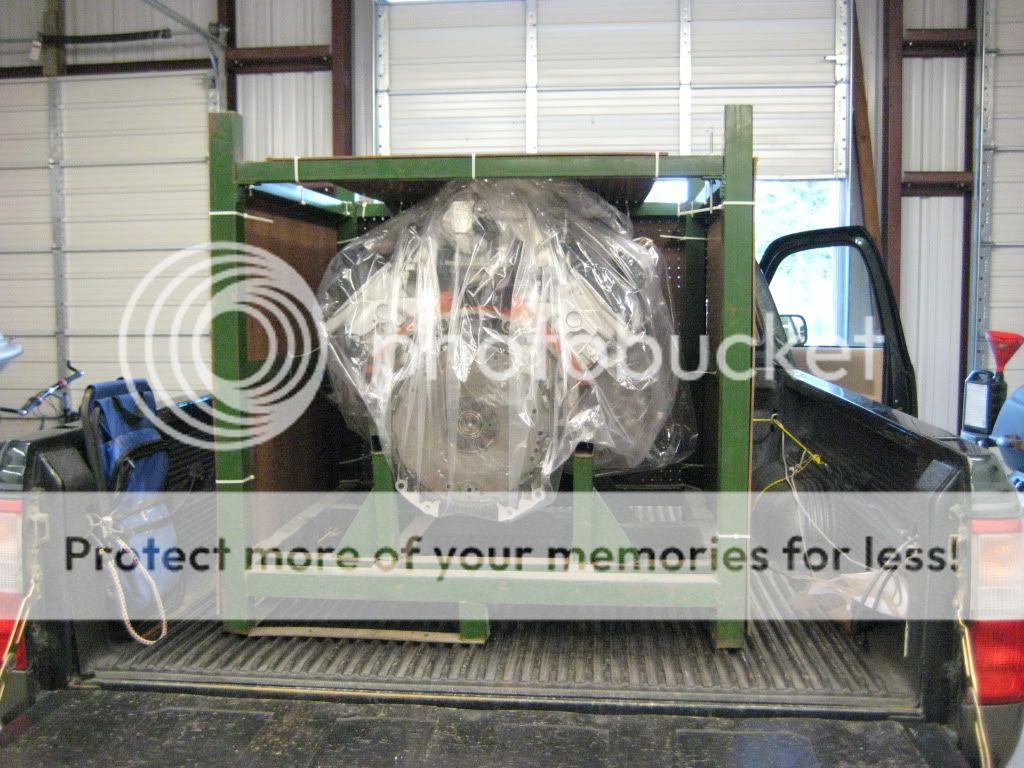

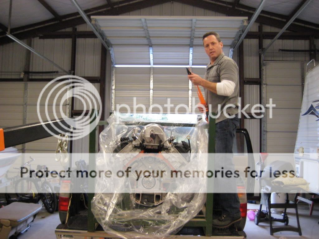

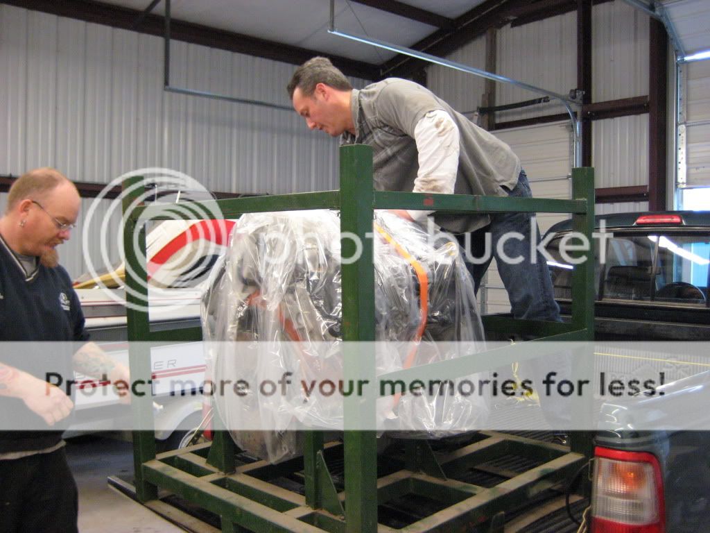

I moved my car over to a buddies....he has a lift!!! And we started the 6.1L removal....which I sold full up to a shop in Arizona. He's gonna be digging the new found power!! I recieved my 392 12/18/09 and uncrated it and installed the 6.1L into the crate....whith hopes of shipping it out today!! Here's a few Pics:
Put'en the 6.1L into the crate!
