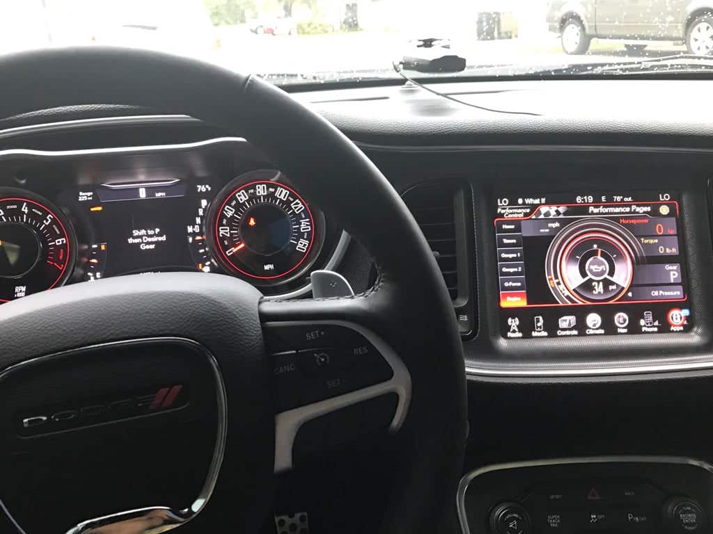

I’m having an issue here. My car is in park and will not come out along with a check engine light. Car was fine when I parked it. This the message it’s giving me
As you can see, from the screen the car is in park and now the gear shifter is not lit like it normally would be to show what gear you’re in and I will not budge from P position. Any ideas what’s going on here?
Sent from my iPhone using Tapatalk

No it’s just the push to start but I’m about to go and disconnect the battery.
The car will start, but it won’t let me shift it out of park and the shifter light does not light up to notify the driver what gear it’s in

Discussion Starter #12
Update:
First I went under the cover near the shifter and that button wasn’t there and while I had it opened I checked and made sure nothing was preventing it from working properly
I then went and pulled fuse 31 and let it sit for about 5 minutes and that didn’t work
I finally just disconnected the battery and went do something else for like 45 minutes and connected the battery back and the shifter started working properly but the check engine light was still on. I drove it around my block a few times, shut it down and came back 10 minutes later and check engine light went off. I really think cars went to sh*t when all these electronics got involved
