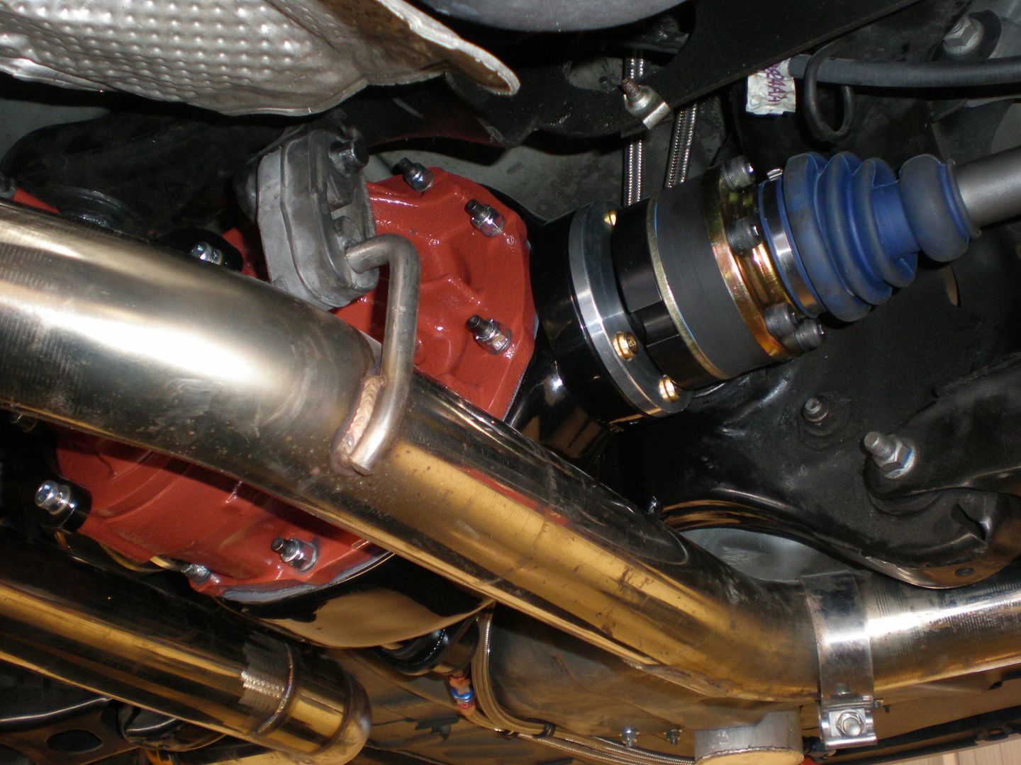

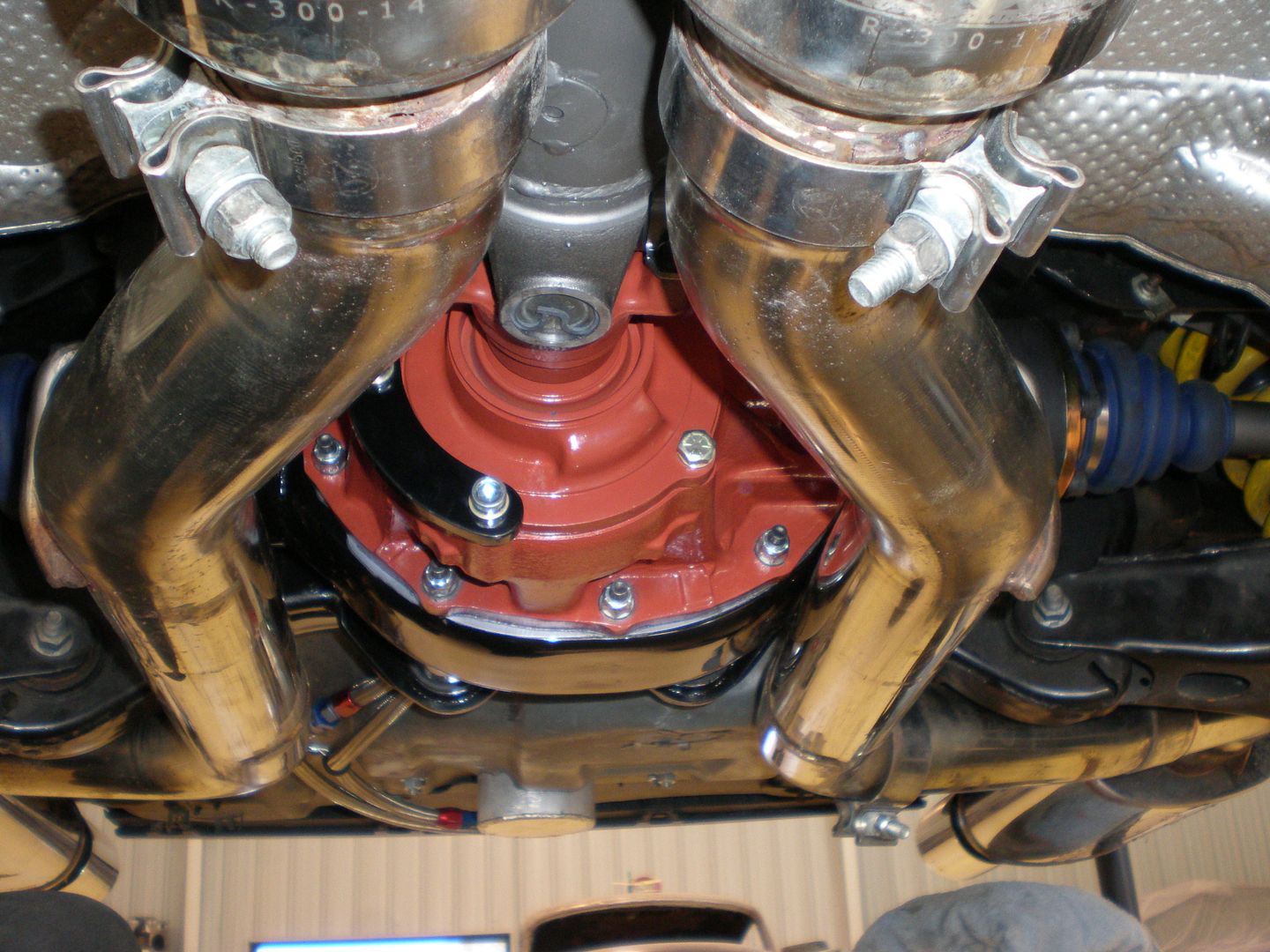

Here are some picture of the 9" install on Papa Kooks car. I have been getting allot of inquiries about the kit and the work needed to install it so i have decided to just post it up and let you take a look. the only fabrication work needed was a small amount on the back edge of the cradle. we supply a template that shows where to cut the sub frame and all you do after is slip in the back mount and weld it, its not real complicated but i would suggest some one with fabricating skills to do the job. if you have any questions please fell free to PM me and i will answer any that you may have.
All fabrication work was done at Bagshaw fabrication of Mooresville (there doing a cage in Georges car now) we are setting up appointments for the install there if anyone is interested please PM me.(kit can be purchased and sent to shop of there choice also)

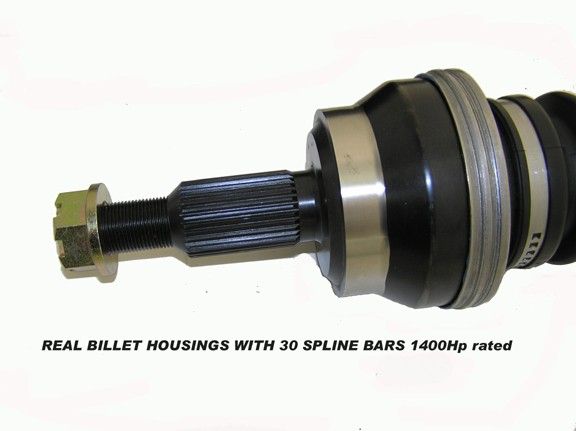

3. 31 spline stubs made from 300m rated at 1400Hp
4. Our signature 1400hp axles with the billet outers and hubs for the 06-08 cars. the 09+ cars will use factory hubs

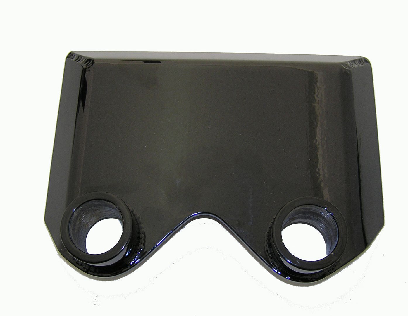

Rear weld in plate, this was powder coated for the show but the one you receive will be natral matal so it can be welded in
front mount
billet outer, the abs rings will need to be moved over
the cage to the left is our 4340Aq Rem polished cage used in all our 1400hp axles
some side angle views

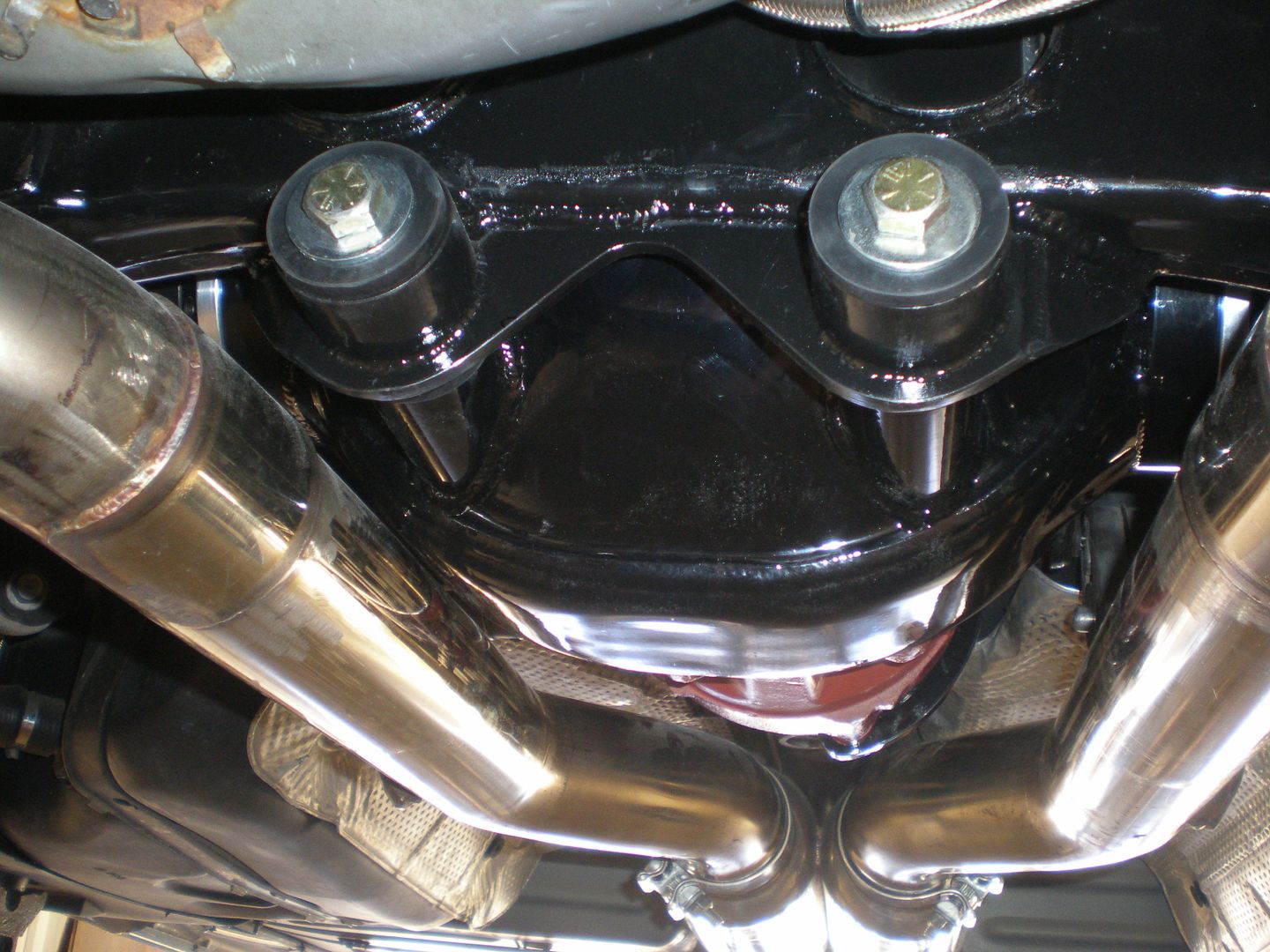

Rear mount after install, looks factory and it will be the last rear this heavy weight will ever need

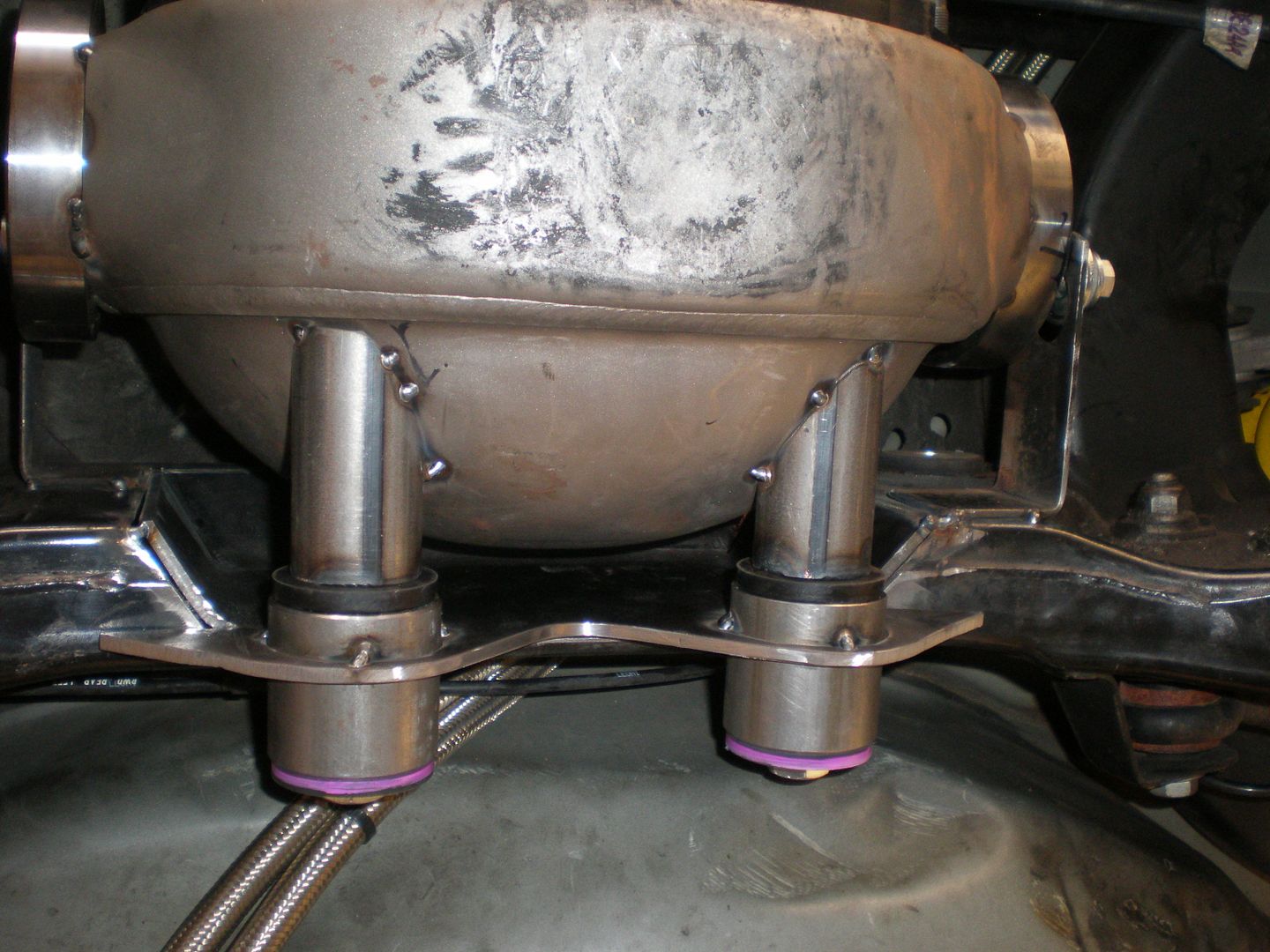

some early mock up photos
fabrication done at Bagshaw fabrication morresville NC
