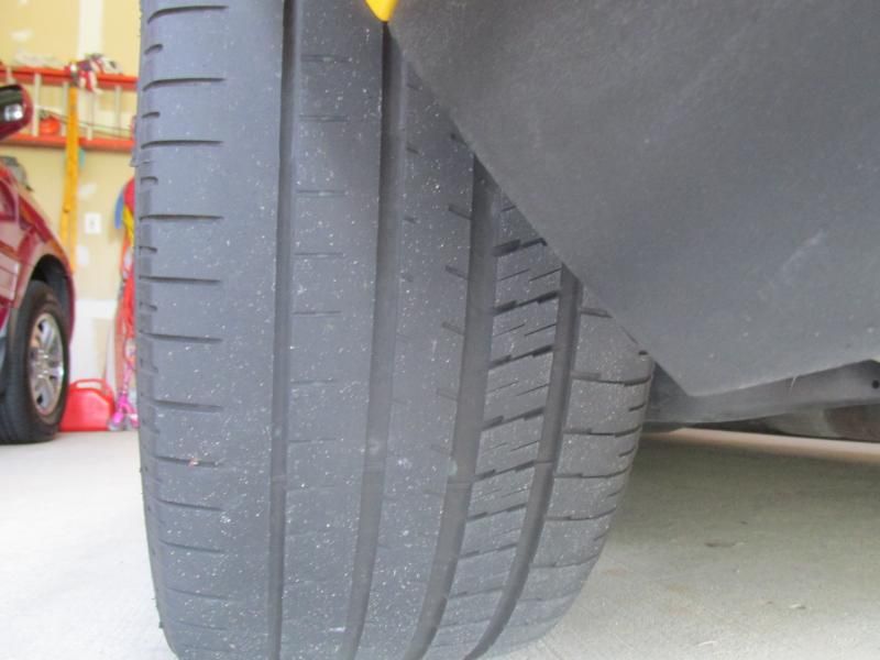

Here are 2 photos of my rear tires. Wear pattern is "somewhat" evident. Tires have 21,200 miles on them. Zero burn outs, no abuse whatsoever....
After talking with Speedlogix and Eibach, I'm thinking about putting off, for now, installing the rear alignment bushing kit. Eibach advised that it is quite probable my rear alignment, after the lowering springs were installed, may have had too much positive toe dialed in to help compensate for increased negative camber as a result of the lowering springs. They suggested dialing back some toe towards the negative side and monitor wear, after new tires are installed...getting this task done this coming week.
One thing I didn't do, my fault....was after I had the springs installed and after they settled in, I didn't take the car back in for a second alignment... This too may be a reason for the increased outside wear on both rear tires.

I'm curious to know how the alignment shop is going to adjust anything on the rear, there is no adjustment with the factory parts. Nada. That's why the Eibach (SPC) camber bushings are needed.
Feathering of the tires would be caused by toe. Wear like you're seeing would be caused by camber.
The only actual alignment adjustment our cars have from the factory is front toe. Anything else requires aftermarket parts to allow adjustments to be made. So, as I said, I'll be interested in hearing how your alignment shop performs an alignment when there's no adjustment.

That said, the wear you're getting looks like camber and not toe.

Yes, camber is an issue and still is. Here's the strange part...sitting at the shop right now. New tires on, mounted, balanced, no problem. Onto the alignment rack, set it up and checked exisiting numbers. Camber RF and RR are off. LF and LR ok....no idea why this happened. It looks like Chrysler/Dodge has a bolt kit for the front that can adjust camber and caster. For the rear it looks like my Eibach bushes will be going in. It's lunch time now so more later....
