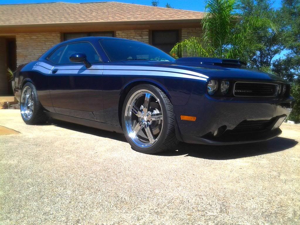

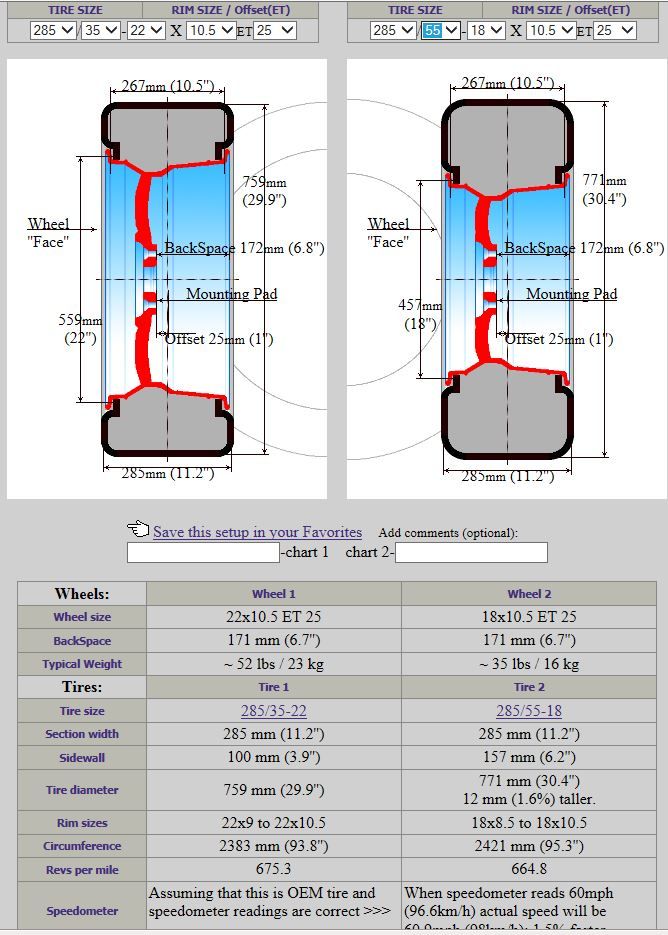

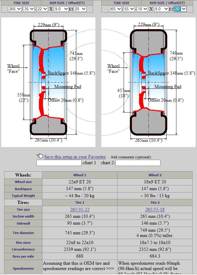

I did a lot of research of tire fitment on modern Challengers before I bought my wheels and tires. I can tell you that what I have is probably the widest (& tallest) rubber you can run, while lowered and have no rubbing issues. I realize that not everyone is into the 22" wheel setup that I have, so I pretty much laid it out below what will work with each wheel sizes, lowered on Eibach Pros. These sizes will probably not fit with the Eibach Sportlines, or similar, lower springs without rubbing issues.

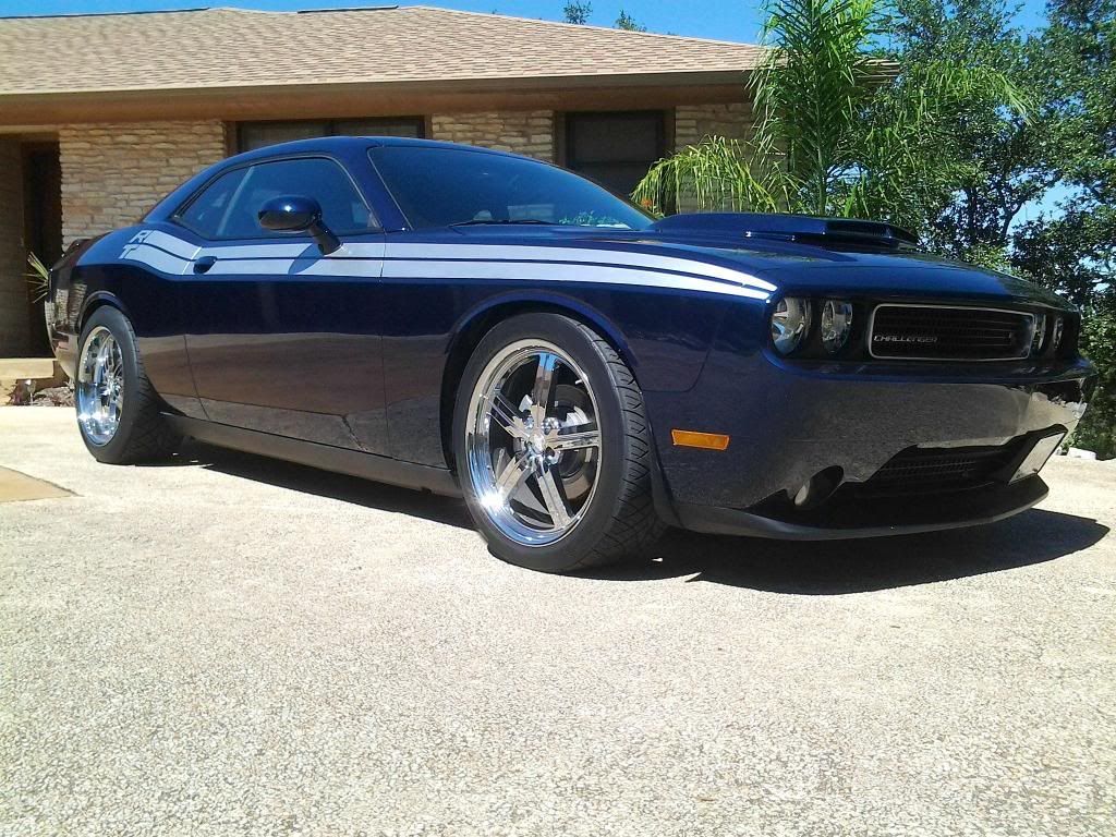

Here is my car with 22's. Below I photo shopped close to what each wheel size will look like with the maximum rubber lowered on Eibach Pros. On the sizing charts below, my tires/wheels are on the left for comparison.

My specs:
Wheels are Huntington Bolsa's
Rear: 10.5" x 22 with 25mm offset
Front: 9.0" x 22 with 20mm offset
Tires are Nitto NT 420's
Rear: 285/35/22
Front: 265/35/22
Eibach Pro Series Springs

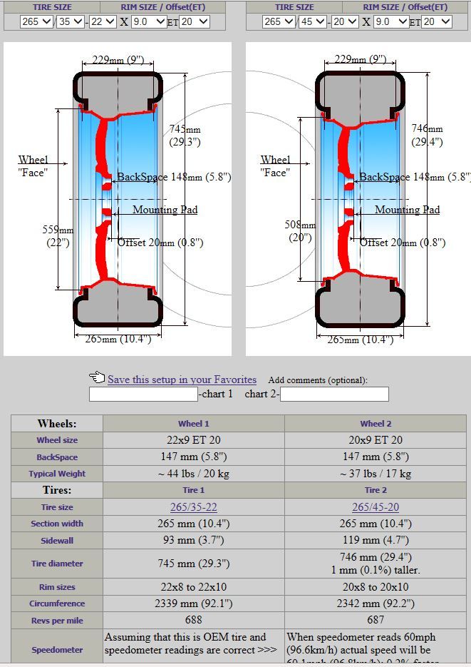

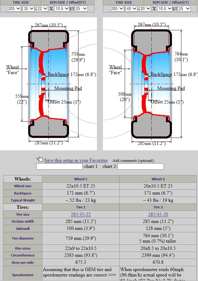

20" specs:
Wheels:
Rear: 10.5" x 20 with 25mm offset
Front: 9.0" x 20 with 20mm offset
Tires
Rear: 285/45/20
Front: 265/45/20
This is really close to how it would look with this setup:
My tires on the left for comparison:
18" specs:
Wheels:
Rear: 10.5" x 18 with 25mm offset
Front: 9.0" x 18 with 20mm offset
Tires
Rear: 285/55/18
Front: 265/55/18
