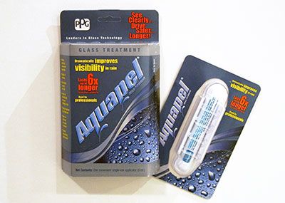

Try Aquapel. I believe Mopar suggests this for the widows to prevent sticking in freezing weather. You coat the (clean) glass and maybe the rubber weatherstripping too.
(I don't know how it works on the windshield)

What is this Aquapel stuff / how do you apply it?
