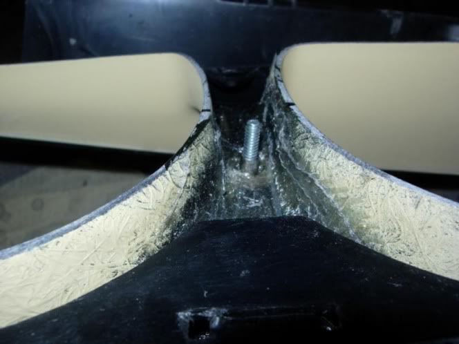

Make sure the mounting studs are securely tightened - finger tight is enough, but make sure to apply some lok-tite
to the threads so it won't viberate loose later on.
Bolt up the aluminum bar as shown in the picture.
