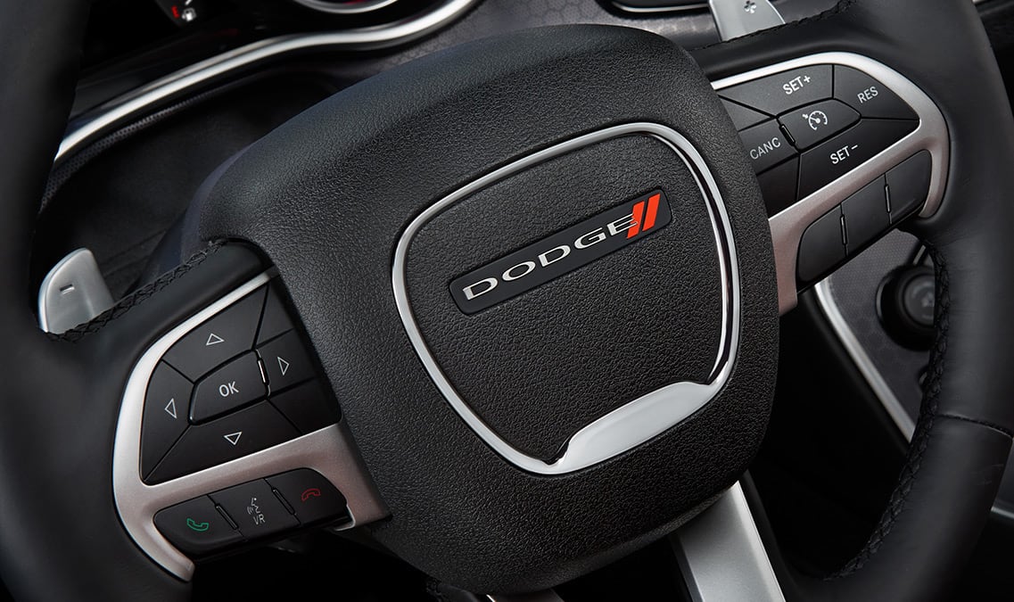

Right on my steering wheel I have 3 blocked off buttons I am guessing is for the adaptive cruise control option. Would it be easy to put small switches here for my nitrous setup? I have an NX Gauge pod that has all my switches but I would rather have them on the steering wheel and open up that gauge spot for a remote pressure gauge.
I would like to put my bottle opener, bottle heater, and activate switch in this spot. I don't mind putting the purge button somewhere else.

I would imagine that you'd be able to do it as long as you can find power for the switches. I don't know what wiring is like under the airbag cover but I would imagine you wouldn't have too hard of a time making it work. I believe someone else did it using the available buttons on the center console by the traction control. Just out of curiosity what kind of setup are you running and how big of a shot?

The Charger Pursuit has an option to use these buttons to power added on accessories but don't know the part number for it, search for Charger Pursuit Auxiliary Switch Assembly.

Those buttons when used communicate via the bus. That is all the buttons share an interface, and the PCM interprets the signals to give you the proper reaction for the proper button. So you'd have to run external wiring somehow. Unless someone makes wireless switches which could just live in that space? :D

Now there's an idea, will the tazer only assign the buttons to certain functions, or allow you to map them to anything?
A Guy
1,449 Posts
The Tazer will only alloy you to map the buttons to other Tazer-enabled functions, such as the custom drive mode, light shows, line lock, etc.
1,064 Posts
Very interesting thoughts on switch location. I'm subing to this thread.
2016 Dodge Challenger Scatpack Torred
153 Posts
You know you could reach out to Tazer support see if you can pay them something for a custom program using those buttons
