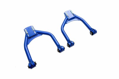

I tried searching on online but just one forum post but not much help, however I found several post about their coil overs and so far no complaints so if they can make good coil overs and even hellcats users are happy I can only assume they good arms as well lol but this is my opinion about these arms you think my opinion is correct?
The Megan racing Look like they use a real ball joint. Some of the other ones use some kind of "thru bolt" ball joint that does not really fit properly.
The only issue I can think of with those type of adj. control arms is that one good hole or bump will cause the position of the Ball Joint to shift.

1. Ask them if it changes the caster with the camber. Another more expensive arm has two adjustments before it comes together at the knuckle joint. The front of the arm controls caster adjustments the rear arm controls the camber.
2. Ask them if just six bolts and friction holds the caster/camber without moving. Another more expensive arm has tabs to LOCK the arms in place. It is impossible for their product to shift.
3. Ask them how easy it is to shift the camber and caster without alignment instruments, since it looks like it just slides laterally.
With these critical aftermarket parts beware of shopping based just on cost. Sorry, you will get what you pay for.
