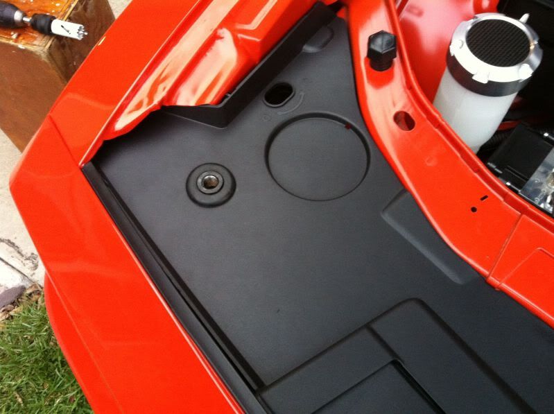

Went to install the Mopar hood pins I picked up last week. I got halfway
thru and had to stop as the guide bit for the 1 1/4" hole saw I have wasn't
long enough to contact hood before the edge. Wasn't going to risk messing
that up so I'll finish up next weekend.
Here's a few photos of how far I got.
Plate install
Drilled out the radiator covers (fyi, if you buy this set drill out with 1 1/4"
hole saw not the 1" the instructions say. Must have been written before
they included the rubber grommet as they don't mention them anywhere).

looks great so far, how did you mark the hole for the plastic headlight cover? I was thinking about using lip stick to put all over the metal mounting piece then installing the plastic light cover over it.
Pull it off and drill where the lipstick is
862 Posts
Discussion Starter · #3 ·
Problem with that is it isn't smooth underneath where the hole goes. It's the
spot where they date code the part etc and there is raised writing and a grid
with #'s etc. I was going to do the same thing. I removed the pin and put
the covers on and lined it up as best I could. I was actually a couple of mm's
off but used an exacto knife to trim a little. The grommets makes it a little
forgiving if your just a little off.
Thanks for the tips, I don't have the mopar hood pins, I have the mr. norms, they look almost in the same location. I will do my best and get it lined up.

Got the hood pins finished up after work. I'll get some better pics tomorrow when
it's light out.

These pins sit at the perfect location on the hood.
Yeah IMO they sit exactly where they should be, most others I've seen
sit to far up the hood.
Nice work Bro,:thumbsup:
Any other issues you ran into or any advice to make the install go smoothly?
Thanks. Like almost anything else, measure, measure and measure again, then
cut lol. The scariest part was cutting my hood. One thing, I used a little dab of
paint on the pin tips to mark the underside of the hood for drilling. I should have
used less, it made a pretty big dot and made it hard to judge where exactly the
center was. In the end no big deal as there is a little room for error. Also have
a good grip on your drill as the hole saw bit is about to make contact, it really
wants to bind as it cuts since the hood is curved where your drilling. Lastly, to
place the black Mopar medallions(??) I ran some blue painters tape from one fender
to the other in front of the pins so I'd have a straight line get the Mopar logos to
line up.
