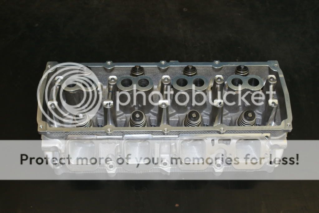

3,881 Posts
Discussion Starter #16
Everyone knows the eagle goes on the left, haha. That pic was originally to show the difference in combustion chambers. Nice catch.
70 Posts
LOL... You're the one who taught me the difference when you sold me on the Eagles for my build.
Nice build Andy!! I can't wait for mine.
903 Posts
Ok I haven't opened up any of the Gen III hemi's so I gotta ask? Which heads are the Eagle heads? I definately see the difference in the combustion chambers, is there any other differences? Will the Eagle heads work on the 6.1 & 5.7 ?
