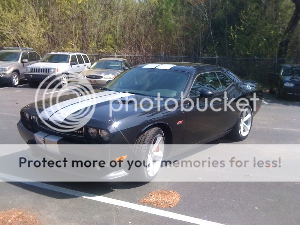

Hello All! I wanted to share the Wife's new ride. We need some help on wheel sizes. I wanna go 22's but not sure how to tell which one's will clear the brembo's. what is the base line offset? any other guidelines I should know before I order? Advice Please!
367 Posts
Leave it stock !! Car looks great the way it is. It's been engineered for 20's. Change it and you'll mess up the dynamics.

Thanks Guys! I got to drive it today (after 5 days of owning it.....)(she keeps the roads hot!) I was very impressed! I am a Corvette restorer by trade and drive a 2010 Ram. I LOVE the new Dodge product!!! We decided on a set of 20's by Boss (Black Pearl) The offset is +35mm. They are not a deep dish wheel. I think they will work do Ya'll? 8.5x20, 265/35/20 with the +35mm? I'll take all the advice I can get! THX!

Damn nice car......just so you know the stock srt8 rims are 20x9 ......your ordered tires are also shorter (less diameter) than your stock tires so your speedo is going to be off (about 4.8%) and your wheel well gap increased
Your Right! (haven't ordered yet) I'm number dizzy from scanning all the threads!

If you go with 20" wheels, I'd suggest that you put, at least, 10" wide wheels on the rear.
So, 8.5" to 9" wheels on the front, 10" to 11" wheels on the rear. Nice!:bigthumb::bigthumb:
