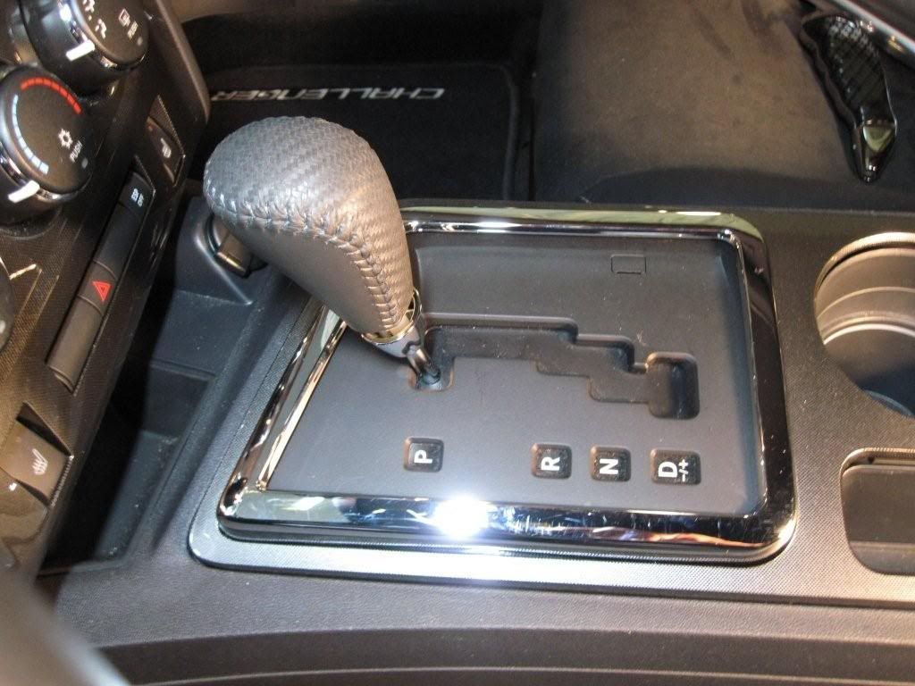

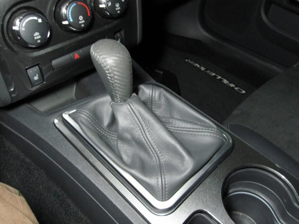

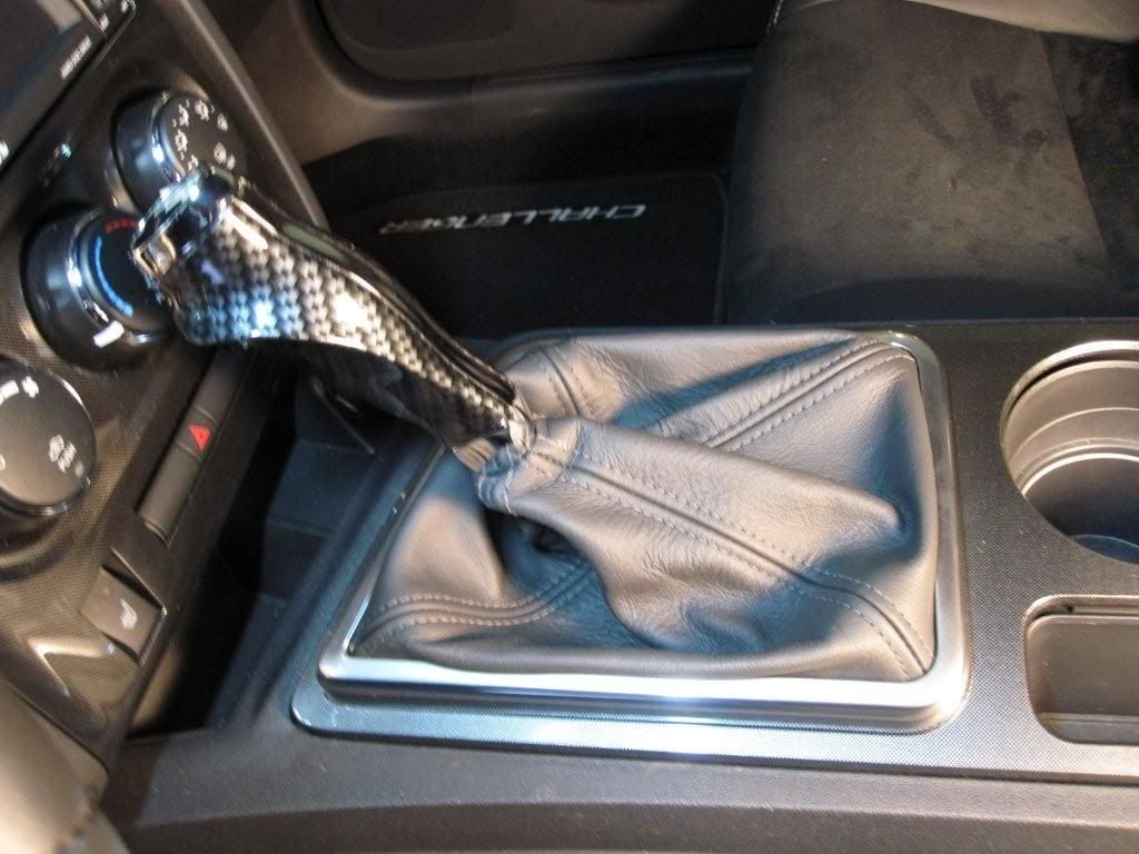

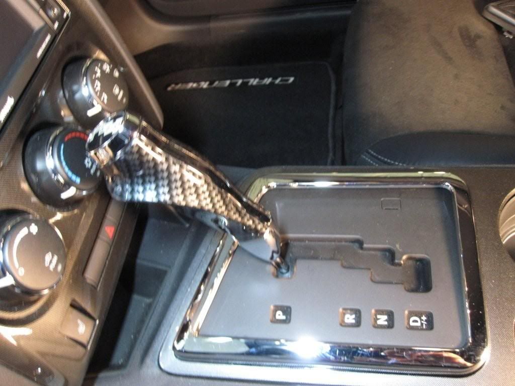

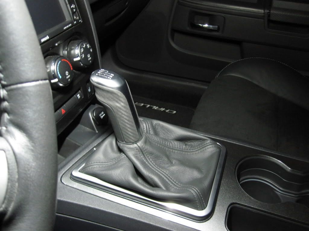

looked like something was missing after installing a new pistol grip shifter on the hot rod recently. Then I recalled someone mentioning a six speed boot really cleaned up the look of the install. I bought a new boot from the dealer that came attached to the the six speed shifter and shaft. once I removed the the boot from the shifter is when ............
STOCK............
BOOT.. STOCK SHIFTER...... FRIENDS LIKED THIS ONE
PISTOL GRIP..STOCK PLATE
PISTOL GRIP....BOOT
Somehow it just looks right..... Going to have a auto gear indicator clear coated sticker made up when I can get up to speed.........

The Gunslinger pistol grip shifter has no clearance issues when installed.
I went with the factory six speed pistol grip shifter and the clear coated sticker will cover the six speed #s on the top of the shifter.........

First thing is to remove the boot from the the factory shifter and rod. There is a plastic cLip that must be removed on the inside and the two can be separated. There is a way to do this without breaking that clip like I did so a manual would come in handy here. Once that is removed you have the shifter with a rod sticking out the bottom of it. There is a hole in that rod just below the shifter handle and that is where the rod is cut off even with the top of that hole. The fun part is drilling a hole the same size as the auto shaft three and half to four inches straight down the middle of that shaft into the new shifter handle. Now just above where you cut that rod is where you are going to install the set screws to hold that new shifter in place. Drill and tap your holes and install the set screws. I had 5mm set screws on hand and that is the size I used. Put the new shifter on the auto shaft and check for fit. If all is well reinstall the boot on the shifter... pull the boot up over your new shifter and install on the auto shaft. Secure your set screws and pop the boot into place.............
Hope this helps Ray. Keep us posted.......
