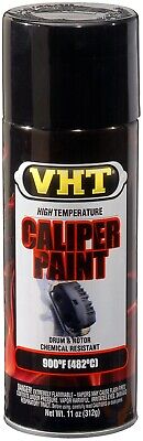

That will work. The most important process is cleaning the caliper (wire brush and wipe with alcohol) and you should be good. I recommend 3-4 light coats and allow drying in between coats and 24 hours to fully cured. I painted mine and left it over night. It's been a few years and they still look great.

Did you do the calipers or the center of the rotors? I don't want to paint the brembos. I wanted to do the center of the rotors.
You can do the rotor hats, but the same is required good prep work.
