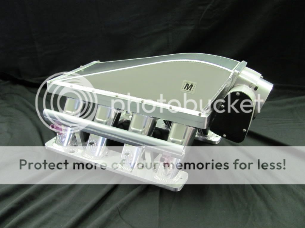

Project Overkill!
419ci Stroker
Manley 4.05" Crank
Manley pro-series I-Beam rods
Manley Pistons
Total-Seal gapless steel rings
tool steel wrist pins
A-1 Technology studs
Billet main caps
ATI OD Balancer
ATI Flexplate
Apache Super Street Heads
Manley Severe Duty Intake Valves
Manley Extreme duty Exhaust Valves
Manley Nextek Springs
PW-FrT235 Camshaft
Custom Twin Turbo kit
4" Intercooler
Pro-Flow Nitrous Kit
90mm throttle body with nitrous jets
Marcella Sheet-Metal Intake
110 lb/hr Injectors
Weldon pump/regulator
SHR Transmission
Custom Bolt-together converter
DSS 9" IRS
CCW Wheels
M&H Tires
I will keep this thread updated as much as possible as the build progresses.

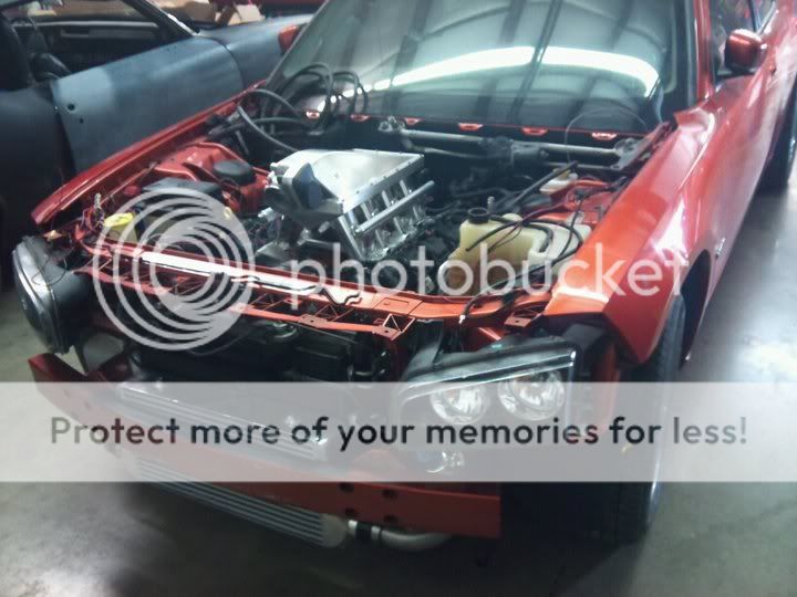

I almost forgot, the tuning of this will be done via Diablosport by none other than Johan himself. Once everything is installed, we will make a couple of dyno pulls on the car to make sure everything is operating, then we will be trailering it to Florida for Johan to work his magic.
457 Posts
where are you gonna mount them snails?
457 Posts
382 Posts
I thought people usually recommend a standalone for turbo applications; how are you using the Diablosport?
Not sure how to answer this? What is preventing me from using Diablosport?
Subscribed. I would _so_ love to see a twin turbo set up on my car.
I hope to be able to fullfill that wish in the next few months, but it will be a long process for sure. Definitely will be complete for next years NMCA circuit.
Maybe I'm misinformed, but I've read a decent amount on here about not being able to tune for partial throttle boost on turbo applications for these cars. Again, this is what I've read; I don't actually have experience tuning turbocharged hemi's.
Most tuners say that it can not be done because they can not do it. I cant do it which is why it is going to Johan.
