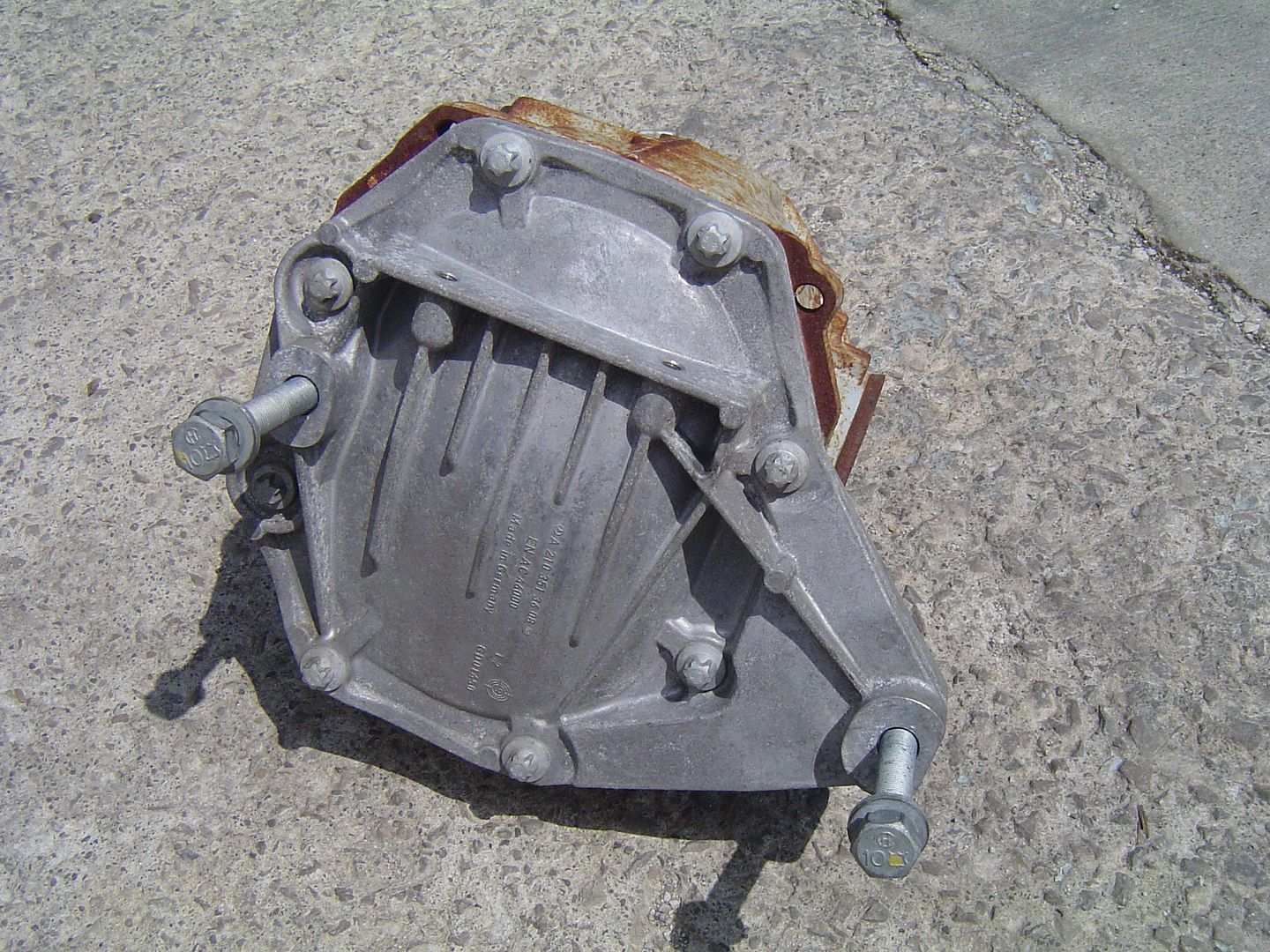

I don't know or care if the 198mm and 200mm are the same, sure the gear is different, but is the housing the same and the Dodge dealer has no clue, so any call is worthless. If it takes the same shafts then functionally it is the same rear. So do a part number check on a ABS axle from 2010 and one from a 2011 if they are the same then any 198mm junk yard rear for $60.00 should do from 3.6 to 3.9 and it is easy to swap out you just need two ratshits on the rear drop and work the diff forward as you unbolt. Gut feeling this is a direct swap. If not pickup the two shafts offer the pick-a-part $150 total and if he says no just start packing up and then well just for you and just for today...
When I do a general search on all shafts used on a Dodge / Chrysler left side I get four total:
2008 Challenger SRT8
215mm DPP EZH
200MM DED ERB
226MM EZC (5.7 MANUAL) EZH DRC
Don't know how accurate it is, note I did NOT see 198mm listed.
This is suppose to be a picture of a 3.06 SE or R/T open diff... it is very different from my 198mm
note that the vendor is listing these SE or R/T as 3.06 with LSD ( I highly doubt it as looks like the standard mittingen), the subframe has an offset bolt hole also, don't know if it has a "normal" semetrical bolt hole for a 198mm diff, my guess is that all 3.06 are 215mm offset bolt for SE or R/T, I need to find a 2.65 diff from a 2011, the fitment is list as "different" so I assume that the 2.65 is like or identical to the 198mm carrier.
198mm
1,569 Posts
so basically look under the rear of your 2011 and see if the diff bolts are symmetrical like the 198mm or offset like the 3.06 above..
