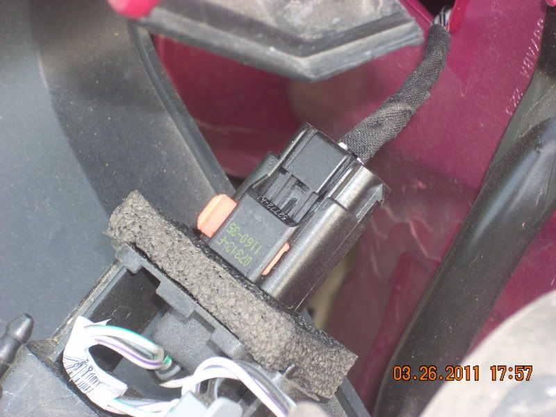

I got the kit in the mail today, but I can't even get past the first page of the instructions (which seems to be very well written). I can't get the 1st connector of the outboard tail light. It says to slide the red lock and push on the cam lock and it will slide off. I slid the red tab, but the cam lock is not releasing. I even got the tail light housing off the car so I could get a good look and i still can't figure it out. Here's a pic of the connector.
thanks,
Kevin

Push the red release button the other way and it should come right off. i did mine in about 1.5 hours and am slightly older than you. Confident that you can install the harness as well. I prefered the on line directions which are the same as the printed directions that came with the harness only the pictures were clear and easier for me to visualize.

I tried everything I could think of. I even had the red clip completely off and the connector wouldn't come off. I'm thinking that maybe I don't need to take it off. There's enough play in the wiring to allow me to remove the hosing from the body. Now I can't figure out how to get the bulbs out of the housing. I need a buddy to pull my head out. :)

Pull the red tab all the way out and push down on the back center of the connector and pull. The hardest part is getting the tail light assembly off. Definitely helped having my son yanking on it with me

I tried that. It will move about a couple mm. I guess I need a second pair of hands. I tend to over-analyze things.

For the original question of how to get the harness loose from the right side taillight...pull the red tab out. Push the cam lock release down with your thumb and wiggle the connector until it comes out. It is really in there tight so keep wiggling it. It will come out. Then remove the bulb and save it.
