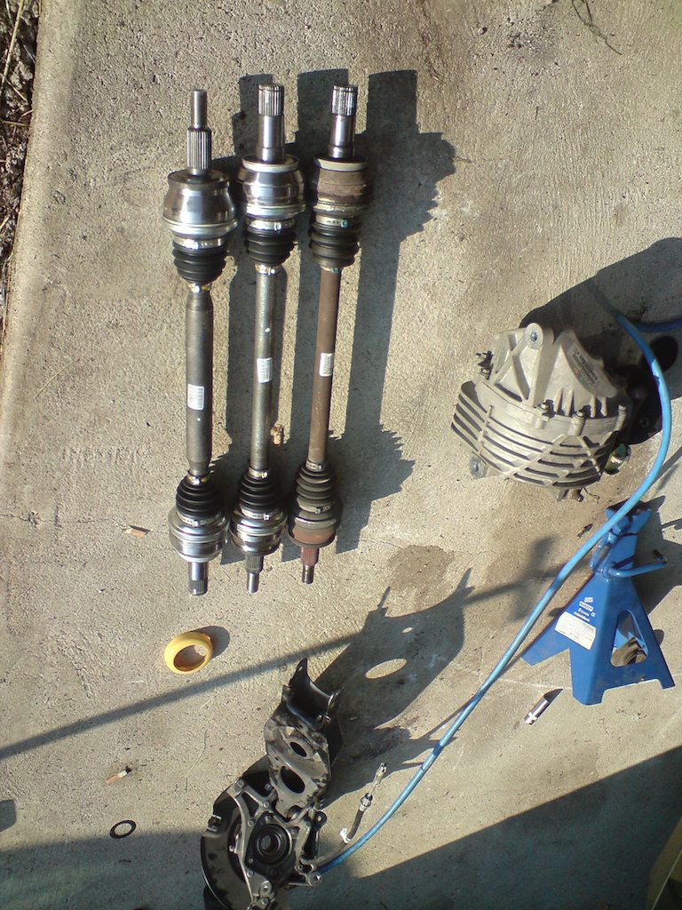

does anybody know if the internals of the stock '09 6speed differential can be purchased somewhere?
My rear diff is nearly gone. It overheated last year on the racetrack with boiling oil and since then the diff doesn't really work anymore. When doing a tight corner it feels like a locked straight axle.
Mikey from BMC offered me a complete new diff but I'm looking for a cheaper way to fix it - if possible.
The '09 6speed have the upgraded 3.92 diff with the 226mm axles.

I'm surprised the car has locked up the diff. Usually when the clutches go you just get one wheel peel.
I think you'll need a beefed up diff for that type of driving. Getting on it hard exiting turns will give those clutches a workout.

I'm fairly confident Dodge does not sell replacement parts for the differential...you have to purchase the entire diff. They're approx. $2K now, and you can do a bit better than that with some discounts.
If you could find the parts that comprise the diff, then you could likely source them from the suppliers but that sounds easier than it is.
