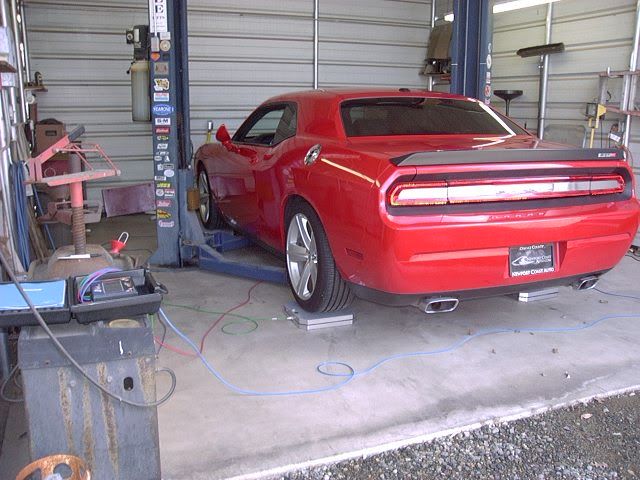

I put my car on the lift for its first oil change since I got it, while it was there I decided to weigh it. For those who care, here are the numbers for my '09 6-speed with 5/8 tank of gas on the gauge. (weights in pounds)
LF= 1127
RF= 1150
LR= 929
RR= 917
Total= 4123
Front= 2277...55.24%
Rear= 1846...44.77%
Left= 2056...49.86%
Right= 2067...50.14%
Math discrepencies are due to rounding off.
Weighed on Rebco 4-corner digital scales.

Is that bone stock, fully loaded, any mods? The reason i ask is because mine is also a six speed with no options, also have an aftermarket exhaust which i know is lighter. I guess i just want to get an idea,till i can get it to a scale.

All the bells and whistles, only mod is a CAI.
wow that weight is lighter than i spected for a fully loaded one. I wonder if mine is a lot closer to the 4000lb mark, guess i'll find out when i get it to a scale.
