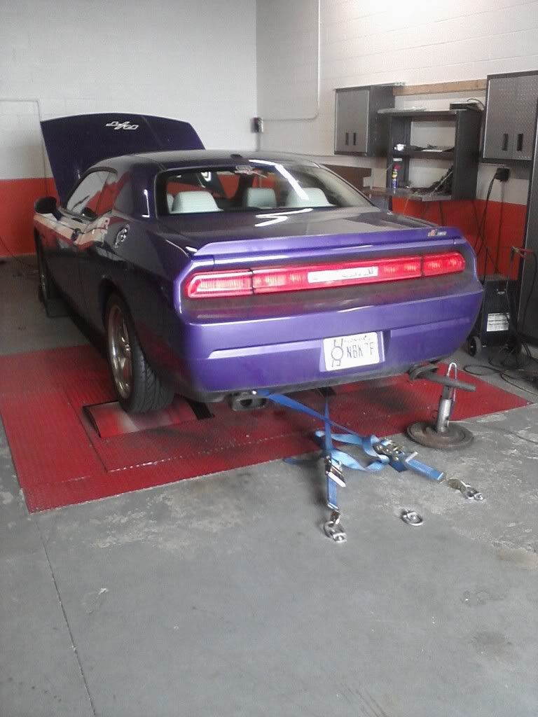

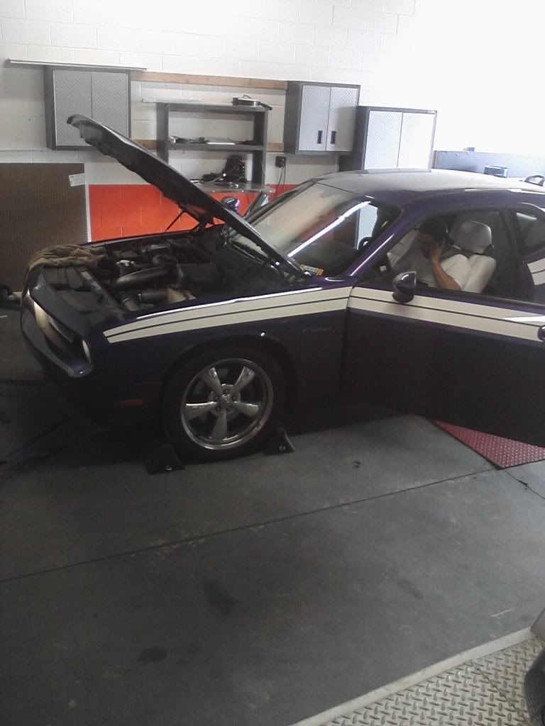

Steve gave me a buzz about two weeks ago looking to get his car retuned for the 91 octane fuel we have in california. Running his 93 octane florida tuned on 91 was not sitting right with him so I gave adam at ST a call and set an appointment up. With steve's busy schedule adam agreed to come in on saturday and tune the plumcrazy challenger. The results were 505rwh 505rwt on 91. I'll post the dyno sheet when adam emails it to me. A little info on the car. 100% stock 6-speed 5.7 with a vortech V3 and meth injection. The car made 7.5lbs of boost with 12* timing, rpm's were set at 6000:thumbsup:

now they all have my license plate and will start to steal my life and impersonate me and possibly even get my pants :D hehehehe
good times today at ST motorsports. Thanks again Adam, car ran great down to San Diego

100% stock? (LT headers and no cats)

Congratulations Steve! Those are decent numbers on a stock bottom end.
