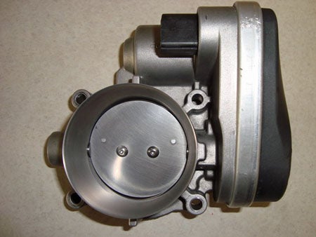

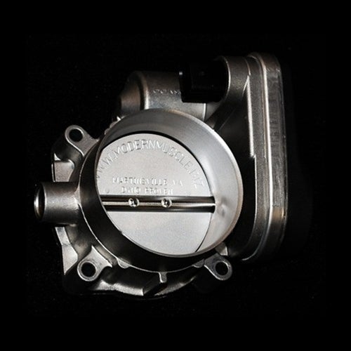

The more air you blow the more HP you make. Modern Muscle says this dyno test was independently done of the MM TB's - 2.7 3.5 V6 5.7 6.1 Hemi high velocity CNC throttle body LX The shaft that the butterfly valve sits on in a TB restricts air flow. The Fastman TB has half of the shaft removed increasing the amount of air through the TB. The Modern Muscle TB does not have half of the shaft removed so it has the stock 64mm, my Fastman TB is now 3mm bigger and $130 cheaper than the MM TB. ENTERPRISE can now warp to 60 in 6.4 seconds after installing the Fastman TB.

Me: "Well all sounds awsome with the information you have provided. I am interested in purchasing one but in the picture you have provided for the TB shows a "lip" on the inside, Would that be bored down?
And also would you say your TB are just as good/if not better than ModernMuscle's Ported TB and Also Speedlogix? Sorry for the questions, I am just trying to find the best deal."
"I can radius the lip slightly. I cannot get to close to the blade or I will send off codes and lightning bolts. Been there done that.
I have been in competition with many vendors since 1999. I am still in business with an excellent reputation over the years.
I looked at your mentioned competitors. Misrepresented sized TB’s and Overpriced. The other looks like a subvendor for the same after mentioned junk and China.
Ask them what is the blade size in their TB’s? -I will answer that for you. Stock.
You see the lip. They have an even worse lip in their poor design.
Your good eyes failed to see a very important advantage of the Fastman TB. The shaft! Look what I have done. It is halved. Now you have a true 3.50mm advantage over there claimed sized TB’s and much better air flow.
Let’s see. I have them matched for size and I have a much better shaft design and I have a better price.
Nobody beats me and I do not have to misrepresent my products."

Just a fyi removing the butterfly and messing with the shaft is what causes issues with other ported TBs just do a search and you will see. Not saying it always happens but beware, As for the fastman being cheaper that is because he only ports one side.
We sold over 400 TBs last year between us and our vendor partners not one unsatisfied customer, Feel free to read the feedback on our and other vendors sites.

Yes my Fastman TB is not ported in the back which means it mates perfectly to the stock intake manifold. If the back of the TB was ported, made bigger the air flowing through it would run into the lip, the edge of the stock intake manifold resulting in less than optimal air flow. Fortunately for SXT owners they can buy a Modern Muscle 3.6 ported intake which would take full advantage of a TB ported on the back. Having half of the shaft removed making the Fastman TB 3.50mm bigger is more important than having the back of TB ported on my motor. There is a thread where several Hemis have thrown codes with the Fastman TB. The moderator Walaby says about his HEMI- Last night I swapped throttle bodies, installing the modified body. Today was my first day driving and all I can say is, folks, if you haven't done this mod, you need to. The throttle response is vastly improved in my opinion, and it now responds the way it should off the show room floor. Personally, I think Dodge should contract with Fastman to modify all stock T/B's as part of their build process. It is a significant difference. Smoother acceleration, quicker throttle response, and just overall better driving experience. http://www.challengertalk.com/forum.../f175/fastman-throttle-body-modification-68835/?highlight=fastman+throttle+body
