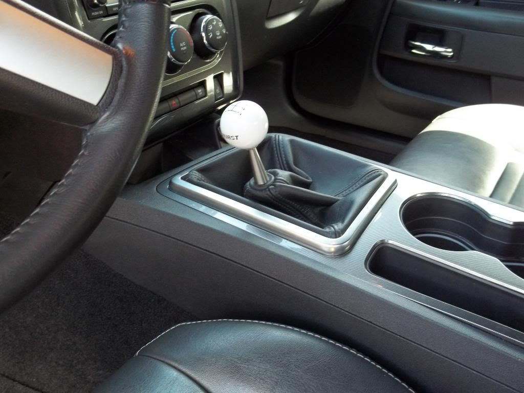

#23 ·
heres,,, mine,,, i dont see this stick and ball combo on their website anymore. I didnt use a spacer,,, but i might add one later to keep the shifter more to the right, if possiable. I like mine,,, it didnt loosen off yet after 1 yr, no threadlock. I bought the hurst badge for my car but all the paint wore off in a month on it,,, they wont replace it,, they kept giving me the run around.
#25 ·
Did you painted the shifter black? Looks really good, like the red ball.
