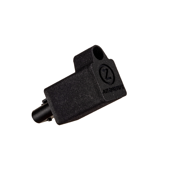

Yes, your solution is this. There are springs in the actuators that will always squeak no matter what you do. The only solution is to keep the valves open all the time using this product here. This product essentially tricks your car into keeping the valves in the open position at all times. Very easy to install and works to eliminate the squeak. Another solution would be getting a cat-back exhaust with valve simulators.

After I sprayed the actuators with wd40 squeak went away after little driving around. I ended up getting the inactive exhaust kit from z auto and I'm extremely happy I did.the exhaust sounds ALOT better and never have to worry about that loud squeaking.

Maybe i misunderstood the video but If you wire the springs open eventually it would set off the CEL..hence why I went with the kit.the kit puts the valves open 100% of the time but tells the computer the valves are still operating correctly.

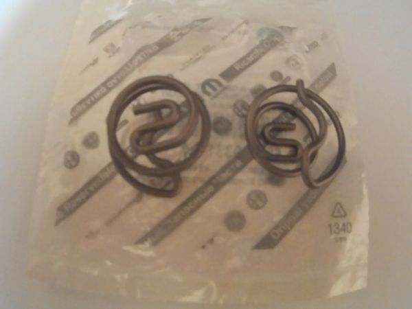

Allright, I finally got to lubricate my squeaky active exhaust actuators under the car. My 2022 RT Plus only has 3,300 miles. I got to employ my two hydraulic lifts and two tripod stands so that I could intermittently and evenly lift both rear sides of the unibody frame. Some recommended spraying penetrating lithium grease, but I used Blaster industrial graphite dry lubricant. It's rated to withstand up to 850 F. It was pretty easy removing the 3 nuts holding each actuator cover plate. I sprayed the graphite and replaced the actuator spring inside the actuator. I was worried if I had replaced the spring as originally installed by the factory. When I started the car remotely, I no longer heard any squeaking! I did hear what sounded like the metal springs reseating themselves inside the actuator. After a test drive and another remote start, I did not hear any more spring clicking.
#11 ·
Oh, no. I viewed a post with a photo that illustrated an active exhaust actuator's spring. I now realize that I may have reversed the orientation of the replaced springs when I closed up the actuators. Looks like I will take the car to the local Dodge dealership for an inspection and correct installation service.

Well, well. The dealership contacted me today about my service request to reinstall the springs inside my active exhaust actuators. I had opened 2 weeks ago the actuators to spray industrial dry graphite to silence squeaky valves; however, I did not correctly position the springs back inside the exhaust valve actuators. I was told that the springs were broken, and new exhaust valve actuators were required. OEM Mopar part is $540 for each side. I could not find the spring sold separately from the actuator assembly itself. What could I say but approve the repair job with new parts.
