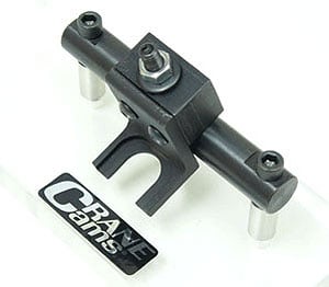

#37 ·
Snap-on has it for $148 which is the one I used to replace my springs with heads still on engine. Although the design makes it a little tricky to get the the far back cylinders by the firewall.
Crane cam makes a tool for $100 which seems to give more access to the keepers.
