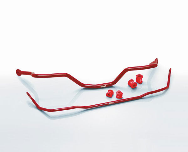

Hi I'm considering these products for my 09 R/T seems to be decently priced

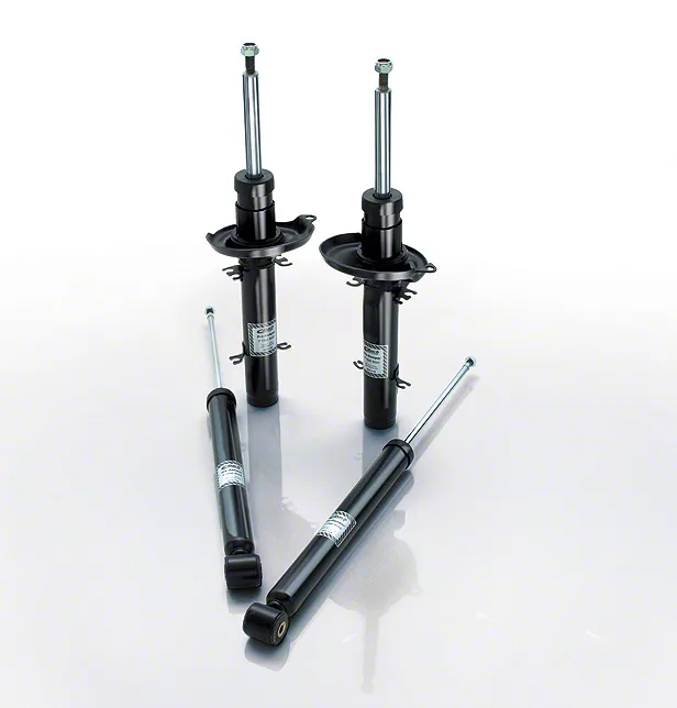

And for shocks and struts. I seen these for a good price but no info on drop. Is this the srt8 set up perhaps?
Does anyone have experience with these? I would like to lower this car somewhat, not crazy but 1 to 1.5" would be ideal especially the front. Is it me or is the 09-10 R/T's way higher in the front than almost any other year of R/T? Strangely my insurance calls my R/T a dodge/Ram, maybe due to the truck struts up front?

Or should I just get coil overs scrap the sway bar idea and put all that money into a set of B.C or peddars or whatever?
For suspension my 2 big gripes about this car is the front wheel gap and body roll. I really miss my 14' SRT8 and I find myself wondering if I should just trade in considering these upgrades, the 6.4 manifold, tuner, CAI and 3:73 or Wavetrac 3:55 I'm planning. I think the price investment is almost the same.

The roll bar kit is Solid 32mm Front, Solid 19mm Rear. Eibach has a kit that is 35mm Front Tubular | 19mm Rear Tubular and are 2 way adjustable for $560 USD, AND I found this low price
The Super Track Pack kit is good and that seems a good price. The sway bar kit as well
The STP kit would lower you about 1/2" if your R/T didn't come with STP from the factory

I don't know there was only 1 setup on SRT8 cars

Just installed 35mm Eibach Bar myself. Have yet to get chance to really test it out. Lucky being a Pursuit already had a 20mm rear bar.
Nice! That is lucky as I've watched a few videos on the rear bar, I think I'll do it when (if) I swap the diff to a getrag. Looks like alot of disassembly to get in there at it.

Can somebody clarify the STP and how those sway bars compare to other options?
No offense to anybody but I don’t understand how it would be physically possible for the car to handle the same without sway bars. I haven’t looked yet, but I assume it’s a direct connection between the body and either the spindle or LCA.

Why do the police cars have larger rear sway bars?
Every other platform I’ve ever dealt with has relied heavily on sway bars for handling. Everything from full-size trucks, to mid-sized SUVs and sedans, to my Audi.
#26 ·
Every major racing, road track, autocross, mountain driving person has always looked into bigger better sway bars to tune the car to their style. Stiffer up front to counter oversteer, stiffer in rear to promote oversteer. Simple as that.

Sway bars, coil springs, strut tower braces, and subframe braces would all be needed to make the car handle okay.

bars are not the answer. Well, not the first answer. Far too often 60's muscle guys reach for bars because that's the only knob they know. Fix the rest of the car, and then consider adding a FRONT bar if you still need more. Rear bar should be absolutely LAST thing to do and carefully at that.
Can you elaborate on why this car doesn’t need more rear bar? Does the car oversteer?

So what about the eibach prodamper struts?
With mopar stage 1 springs? The more photos I see of the eibach pro springs they look too low to me.
The mopar STP in my original post I'd rather avoid if I'll barely see 1/2" lower.
I guess anything I do will be an improvement over what's on there stock being an 09.
