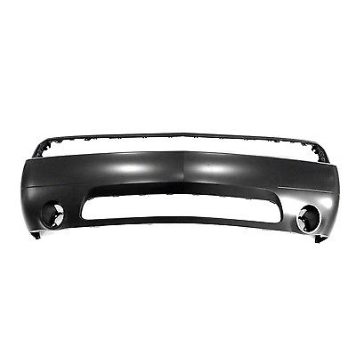

Anyone ever buy/install one. A few minor blemishes/dings on the front bumper of my car and the paint has had a few too many caked on bugs (before I bought it). It’s the one spot on my car I’m not happy with.
I’ve seen a couple of places that sell a replacement front bumper and you can even buy them already painted with factory colors.
Curious if anyone had done this. what the install entails and how well the paint matched etc.
I’m also taking it to a body shop to get their estimate to make the bumper “like new” again and then I’ll determine which road to take.

I've done it with an OEM fascia, which doesn't come painted. It will take a body shop to match the paint no matter what you do.

I replaced the front bumper of my previous Challenger a couple of years ago. It's not too hard but it does take some time. You will need to reuse your current fascia, upper and lower grilles, fog lights, lip spoiler etc. There are a couple of videos in YouTube that can help.

It's not "buy and install".
You need to build the bumper. You need to take everything out of your old bumper and transfer it to the new bumper, without damaging anything or scratching the new bumper.
This will not be a small challenge for a novice.
Good info. I figured it was a pretty involved install. I don’t consider myself a novice by any means when it comes to anything mechanical, but I am also busy and have to weigh the time involved vs the reward of doing it myself instead of just taking it to the body shop.
Part of me thinks it would be a fun project. The other part of me reminds myself of times I’ve been waist deep in a project and asking “why the hell am I doing this???” lol
