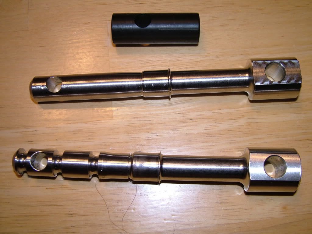

As many of you might know I broke my Hurst short throw shifter last fall. I decided to fix the "weak" link in a really nice shifter. And for you guys tired of blowing your O-rings out and sending your shifter back to Hurst only to do it again later.... Here is the fix.. A new throw rod that eliminates the O-rings. I am looking for interest for me to make a run of these throw rods. All you need to do is remove the old throw rod, Install a delrin bushing in the shifter block then install the throw rod in the shifter ball and socket and install the shifter block back on the throw rod. There is hardly any vibration at cruise but some tranny whine using the pistol grip shifter. If you had the radio on or the windows open I doubt you would hear it. And some vibration at wide open throttle. It really does tighten up the shifter. The shift is far more positive. If you are interested give me a PM...

The price will be $85 for the kit and $5.00 for shipping for a total of $90. What you get.. The updated throw rod with bushings installed. A bushing for the shifter adapter block and a driver to install bushing into the adapter block. And instructions. I have a couple left of this first run. PM me if you are interested.

Here are a few pics of the shifter block. A horizontal pin holds the block on the shift rod. Once you remove the screw and the pin you can work the block off the large o-rings that are on the throw rod. A bushing is driven into the block. Remove the small C-clip that holds the throw rod in. Then drive out the throw rod from the ball and socket. Assembly is in reverse order, driving the new throw rod in. Then drive the block on to the throw rod making sure the hole lines up for the horizontal pin.

I would highly recommend this recently installed mod....
I'll start out by saying when the stock shifter rod was removed it had major damage to the upper and lower o-rings plus damage to the back support section where you could tell the block had impacted it with force.
With the new shifter rod you "know" when your in gear so you will not miss gears as you may with the spongy feeling of the stock shifter rod.
All in all an excellent mod... gives you the feeling like you're shifting a race car.
You do get some vibration noise but nothing that's obnoxious.
#28 · (Edited)
Just to clarify 09b5srt... When he refers to "Stock shifter" He means the Hurst short throw shifter.... His shifter could rotate aprox. 20 degs and the 2 o-rings that he mentioned were almost crushed. This shifter was only in for 4 months.
