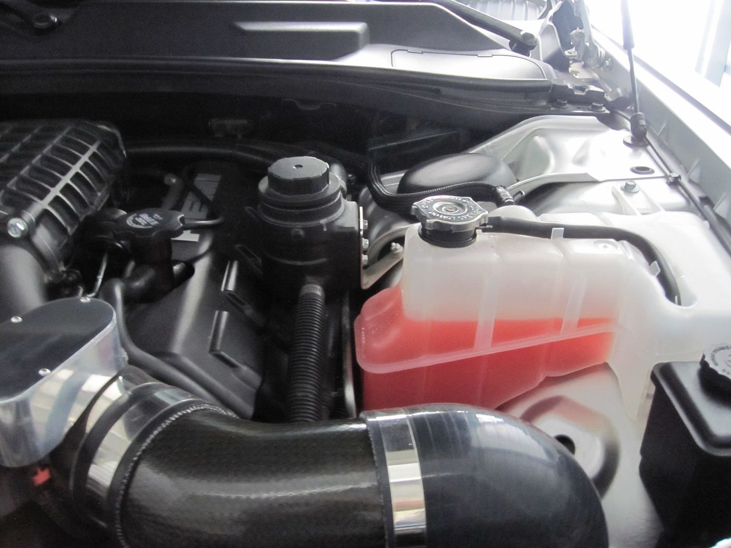

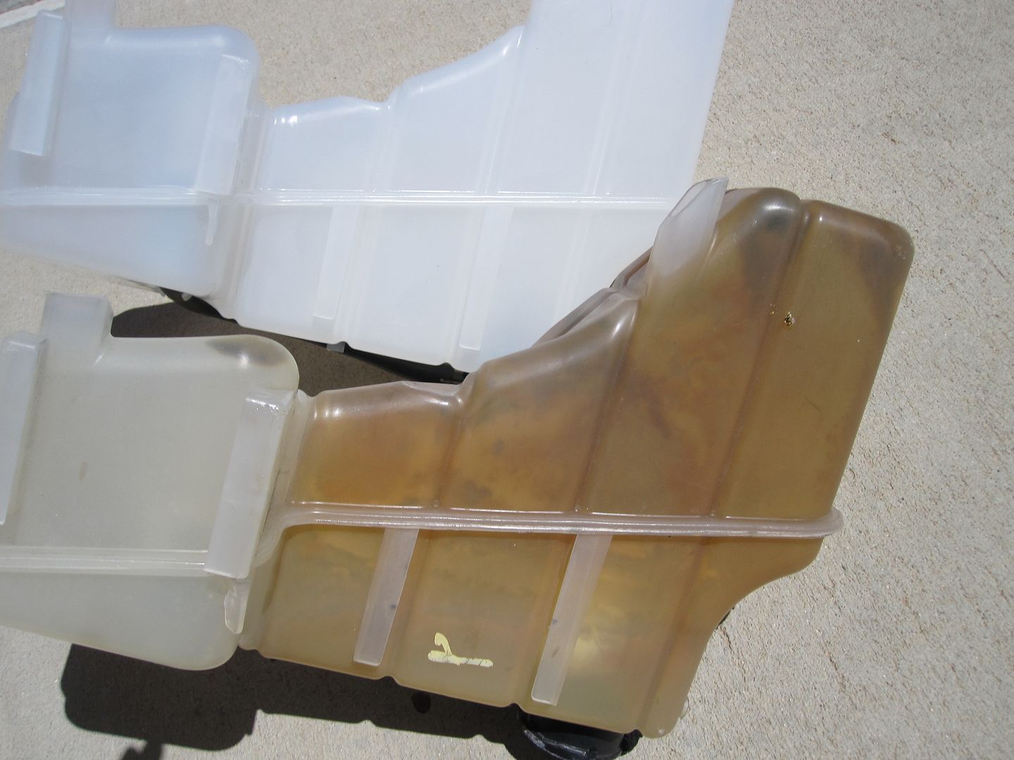

After reading this thread, decided to check out the cooling system on the 09 SRT. Had changed the coolant in 2010 at 2,500 miles when I installed the SC and now, at 13,500 miles and nine years later, discovered that I was a little behind in the maintenance of the system. The tank was a mess and after flushing the system, installing a new tank and coolant, I'm good to go. That won't happen again....
HOT ROD ON
