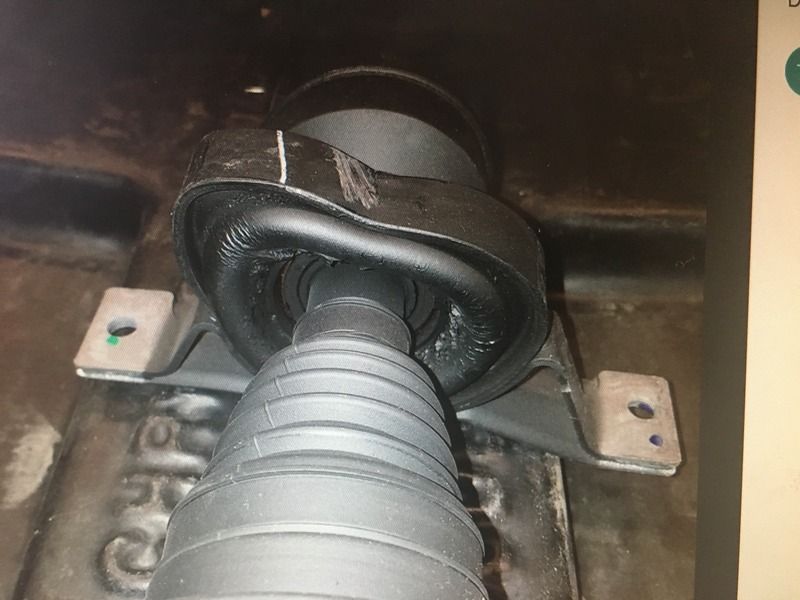

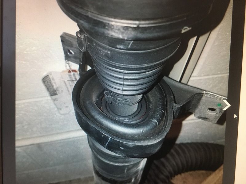

#44 ·
Ok, so check this out, not one...but two driveshafts were shipped to my dealer, both showed up damaged!!!
And now this part is on a national back order, so I'm stuck waiting LOL I promise to report back when it's done to let everyone know if this really quiets things down.
